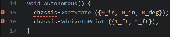

Thanks! It now works. But when I try to use it in my auton, it says that the “chassis” is undefined.
void autonomous() {
   chassis->setState ({0_in, 0_in, 0_deg});
   chassis->driveToPoint ({1_ft, 1_ft});
Your have to define the chassis in a header file.
Don’t define it in a header file, that would cause linker errors. You don’t even need to declare it in a header file, as you aren’t using multiple files.
You just need to define the chassis to be in global scope, outside of the initialize function where it currently lives, so that the other functions in the file can see it. You can either do that by moving the entire declaration and builder chain to be outside of initialize, or you can do as the tutorials say (recommended):
std::shared_ptr<OdomChassisController> chassis; // empty
void initialize() {
  chassis = ChassisControllerBuilder()...build();
