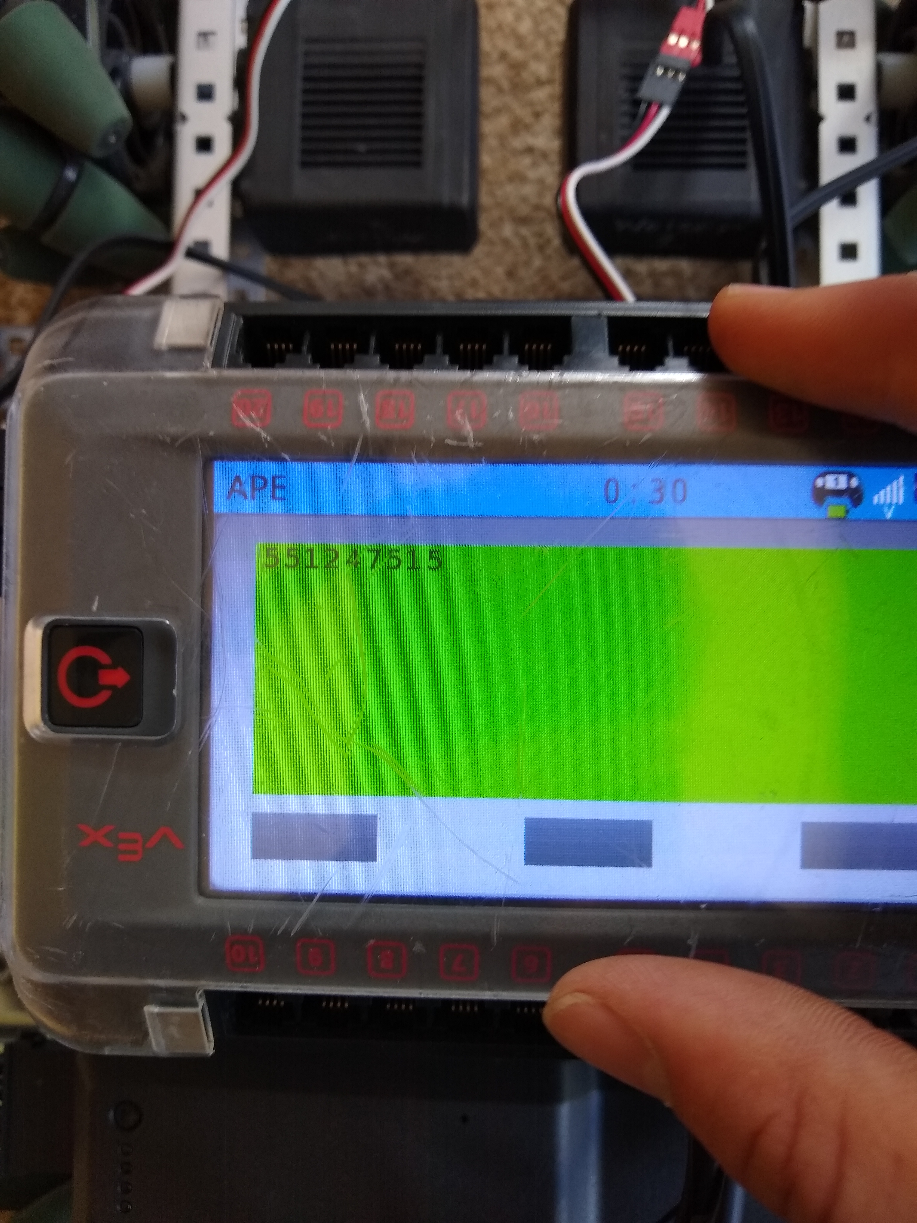

I think I’ll making my own movement functions. How do I get the x and the y of where I am? I did chassis->getState().x and it is a variable qlength. I cannot find a way to get the qlength to be a double. Any ideas? Should I just use the encoder values?
To convert a dimensioned unit to a value, use .convert(unit).
For example, use x.convert(inch).

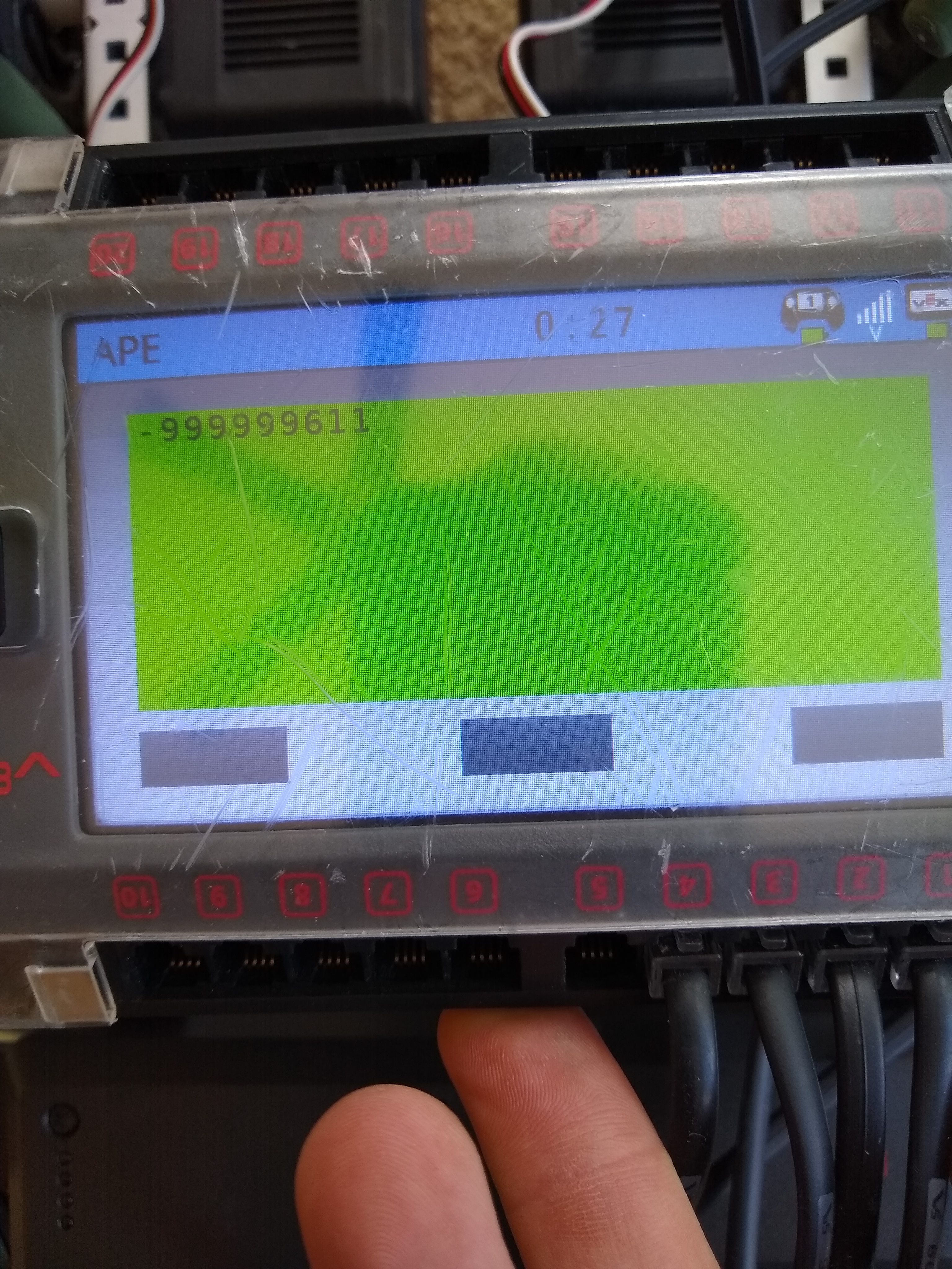

This has been giving me an output that is massive.
You should not start the odometry until the sensors have a chance to initialize.
I have a somewhat related question. I’m running position tracking and motion control on vexcode. After any maneuver larger than a simple straight line or turn, when I have the robot return to the origin, it ends around 2 inches off of where it should be, in one or both directions.
I know the issue is not with the motion control, as I’m outputting values to the brain screen, and they are correct. Is there anything I should try to increase the accuracy of my position tracking? (using a three wheel setup on x-drive)
I wait two seconds in the initialize. Then I used this code
pros::lcd::print(0, "%d", chassis->getState().x.convert(inch));
This is what outputs.
Make sure that your tracking wheels are making good contact with the ground and that all of your measurements are accurate. This helped me the most and I’m using a mecanum drive with three tracking wheels.
Alright, thanks. I’m thinking of adding more rubber bands, that might do the trick.
Nevermind, I had to use %f instead of %d. That fixed it.
