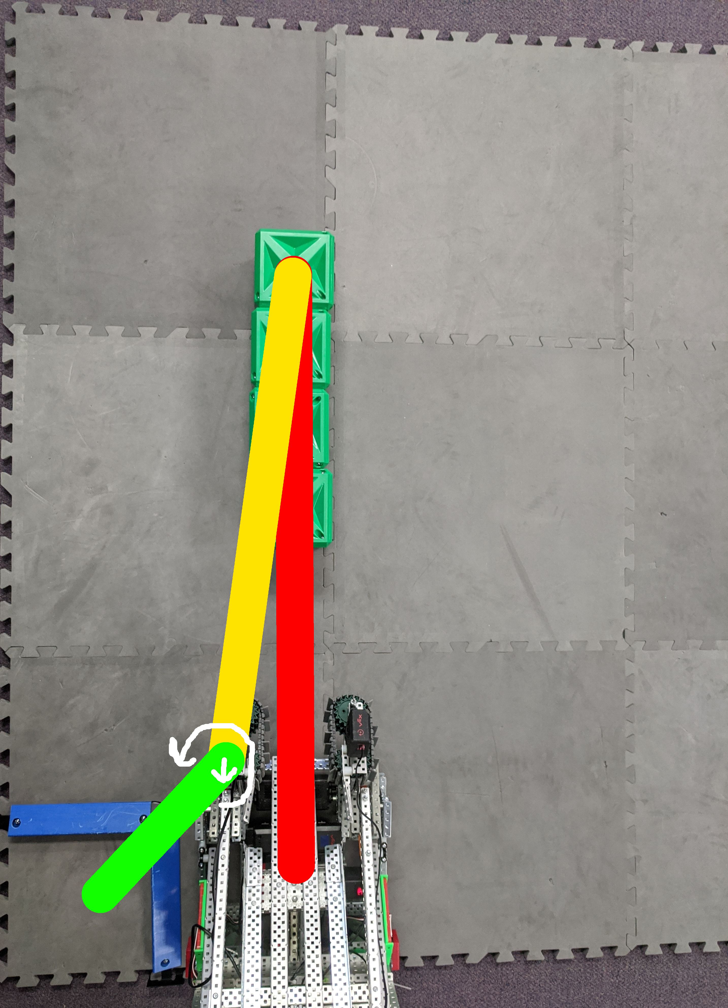

Odometry not turning the correct way
Chassis declaration
Motor frontLeftMotor(9, false, AbstractMotor::gearset::green, AbstractMotor::encoderUnits::degrees);
Motor backLeftMotor(10, false, AbstractMotor::gearset::green, AbstractMotor::encoderUnits::degrees);
Motor frontRightMotor(2, true, AbstractMotor::gearset::green, AbstractMotor::encoderUnits::degrees);
Motor backRightMotor(3, true, AbstractMotor::gearset::green, AbstractMotor::encoderUnits::degrees);
std::shared_ptr<OdomChassisController> chassis = ChassisControllerBuilder()
	.withMotors(frontLeftMotor, frontRightMotor, backRightMotor, backLeftMotor)
  .withMaxVelocity(150)
  .withSensors(leftEncoder, rightEncoder)
    .withGains(
        {0.0035, 0, 0}, // Distance controller gains
        {0.003, 0, 0}, // Turn controller gains
        {0.002, 0, 0.00006}  // Angle controller gains (helps drive straight)
    .withDimensions(AbstractMotor::gearset::green, {{3.5_in, 23.5_in}, imev5BlueTPR})
    .withOdometry() // use the same scales as the chassis (above)
    .buildOdometry(); // build an odometry chassis
Auton code
  chassis->setState({0_in, 0_in, 0_deg});
  chassis->setMaxVelocity(100);
  Roller.moveVelocity(200);
  chassis->driveToPoint({4.5_ft, 0_ft});
  chassis->driveToPoint({1_ft, 0_ft});
  Roller.moveVelocity(0);
  chassis->driveToPoint({0.7_ft, -0.4_ft});
When I run this code the robot follows the lines on the photo. When it gets to were the yellow and green lines touch instead of making a small turn it turns all the way around to face the goal zone. It also does this when I set the backwards flag to true.

I changed the size and cartridges in the code because I’m using mechanum drive and if I set the actual values it didn’t drive the correct distances. Is there a better way to adjust that?
My mecanum wheels (as is most of my kit) are on loan so I cannot test if they are treated differently than omni’s or traction. However, I too have problems with distance being exact, but the distance is consistent each run.
I haven’t been using odometry but I’ll try to find some time tonight to add it in and see if it impacts turning. Though turning is an other thing that is not even close to the value selected but it is consistent.
TL:DR the turn is as expected.
Ok, so I ran your drive steps and log shows it doing what you noted. You can try using turnAngle to see if you can get to turn in the positive direction with a smaller angle.
What it is doing is calculating atan of (about) -.4/-.3 which is -127 deg and then subtracting the current heading of 177 (ideally it would have been 180) from it (-127 -177) or about -304. Of course odom is using the end position from the encoders so the 0-.4 and .7-1 are the ideal number which is why the log shows -307. I guess they could optimize it by looking to see if if adding 360 or subtracting 360 would result in an smaller magnitude (or any other method). note i’m using 4" wheels and a track of 10.5".

I had tried turnAngle witch did turn correctly but when I told it to drive to the last point it would than turn 360 than drive to the goal. I might go look at the code for this and see if I can get it to not do that. What debugging were you using to get that output?
