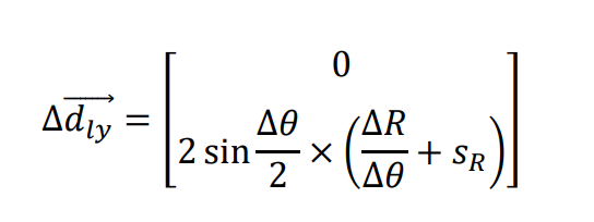

Not necessarily, you can account for it not being centered with a little bit of math. This is shown by this equation from the pilons document
You can get deltaTheta from the inertial sensor and deltaR from the one tracking wheel. Then you just need to add the offset amount (s_R) to the radius of the tracking wheel’s arc. This will then use the center of the robot as the tracking center instead of the wheel position.
Even if you didn’t add the offset, the position tracking system would still work. It would just track using the wheel’s position as the tracking center instead of the robot’s center.
ah interesting I didn’t realize you could do that. Good thing to know.
