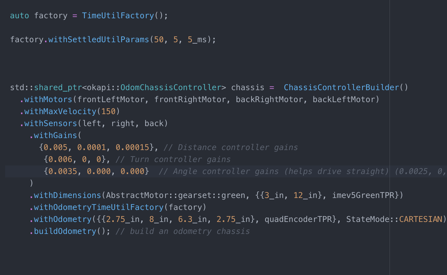

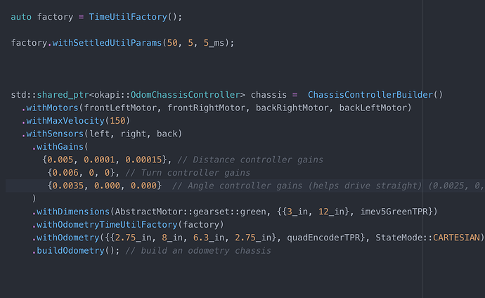

I am currently using the OkapiLib in my code. I have noticed that there is a significant pause/delay/gap between movements in the code. I also saw there was a TimeFactoryUtil method but I am not sure how to use it properly. The code below seems to have no effect

I think what you’ll actually want to do is replace :
.withOdometryTimeUtilFactory(factory)
with
.withOdometryTimeUtilFactory({50, 5, 5_ms})
Which implicitly uses the ConfigurableTimeUtilFactory class. The call to factory.withSettledUtilParams does not actually change the state of the factory, it just returns a TimeUtil
You may also want to test how this behaves without the PID and see if there are still delays between moves.

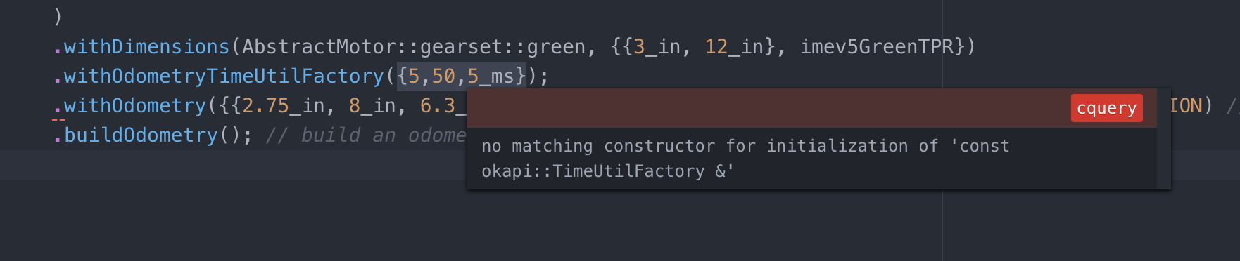

Sorry for the late response. I looked into what you said and tried replacing the code with what you have suggested and I am still getting this error. Screen Shot 2021-03-16 at 11.53.32 AM . If you know how to fix this error please let me know. Thanks for your help!
remove the semicolon
That wasn’t the problem sadly. I removed it and it keeps saying there’s no matching constructor.
The line might not be able to use the {5,50,50_ms} syntactic sugar and may be:
withOdometryTimeUtilFactory(ConfigurableTimeUtilFactory(5,50,50_ms))
Probably don’t want the settle time to be below 10-20 milliseconds as I don’t think sensors update at that rate
Thanks so much, that seemed to do the trick editor wise. I will have to see what the effect is on the robot. I just had one last question, how would you use the logger like you described before?
