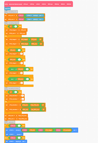

We were using this code to regulate flywheell rpm both in auton and driver control. After testing we ended up realising that a flywheel itself was a bad idea so we went with now building a catapult
sorry for the code being 2 pictures, it is a bit too long to fit on one
the myblock itself is kept in a while loop when it is called, not the myblock code
