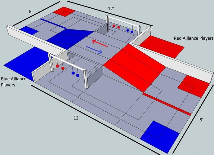

Osbourn Park High School will be hosting the first annual RoboRally. This off season event will feature the new game “Over Under.” Follow the link to find the game manual. This game will be a fast and fun racing game, with a couple of objectives beyond making laps. The game layout is attached

I may have missed it but where are the starting positions?
Jon
They are the 2 blue and 2 red squares inside the field. One red and one blue start on each side of the field. Those squares are representative of a red/blue foam tile.

Being only 3 weeks after Worlds, I am not sure if we could have a robot ready.
I am worried that Line Following robots will have unnecessary trouble tracking the white lines in the corners of the field if red and blue tiles are actually used there.
Will the real field use those colored tiles in its corners?
Blake
Will the real field’s sides be open as is shown in the illustrations of the field, or are the fields walls removed from the illustrations just so that we can see the playing surface better?
Blake
PS: I have field perimeter panels we can use if you are running short on panels.
I am worried that line Tracking Robots will have find turning the 90 degreee corners of the currently layout very hard to do at reasonablely high speeds.
I suggest changing those corners so that they use a couple of 45 degree corners, or three 30 degree corners, instead of one 90 degree corner.
Blake
Is the event listed in the RobotEvents site yet? - I couldn’t find it yet.
Rules tell us that the ramps are made of 1/4 plywood; but with that said, I’m not 100% certain whether or not that 1/4" plywood will be covered by foam tiles, or will be painted, or will be raw (ply)wood, or will have grip tape strips on it , or …
What will the ramp surface be?
What is the distance from the entrance/exit of the tunnel to the center line of the goal post holding the racquetballs?
Is the Goal post made out of wood 2x4s?
Please publish an illustration (a straight-down top view would probably work well) that shows the distances between the field features and the whitelines, as well as the distances between the lines themselves.
If this can easily described in words instead of a drawing, then a drawing isn’t required.
The colored arrows shown on top of the tunnel could mean that each alliance has one whiteline figure 8 assigned for their use and that the other alliance should stay off of that line. Is there any sort of allocation of the lines to the alliances?
The colored arrows shown on top of the tunnel could mean that each alliance has to drive on their assigned side of the “road” when driving around the track. Is this the case or may any robot drive in any direction or location with impunity so long as they don’t trigger the penalty associated with their lap line?
During the autonomous period (or whenever a robot initially moves) do the robots receive 2 points the first time they cross their lap line, even though they have not completed a true lap around the track?
To earn points for making a lap, does the robot have to fully cross over the lap line (go past the colored bar and be fully over the grey tiles beyond the lap line), or will a robot partially across the line get the points?
If a robot partially across its lap line will reveive points, will a robot that has crossed any part of the lap line get points for making a lap, or must some part of the robot be fully across the line?
