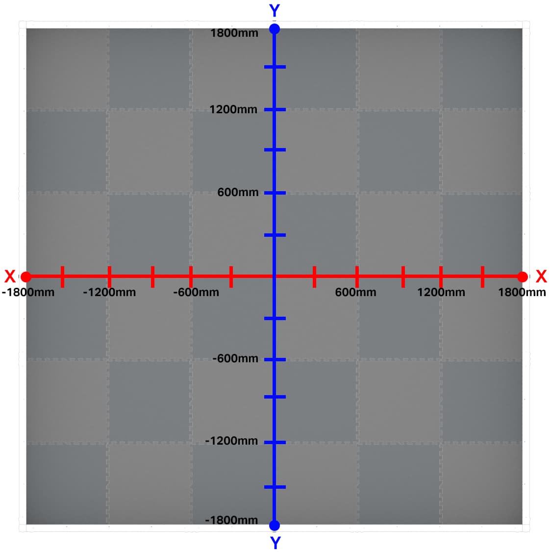

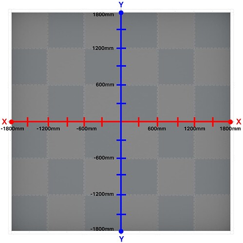

Does it reliably drive to the same location when started from the same position?
If so, it is possible that the coordinate and heading system reported by the GPS sensor is different than the coordinate and heading conventions used by OkapiLib. The GPS sensor natively returns position based on:
Where up is 0-degrees, and clockwise increases heading. I am not sure what convention OkapiLib uses.
No I’ll start it from the same place and it goes to different points
