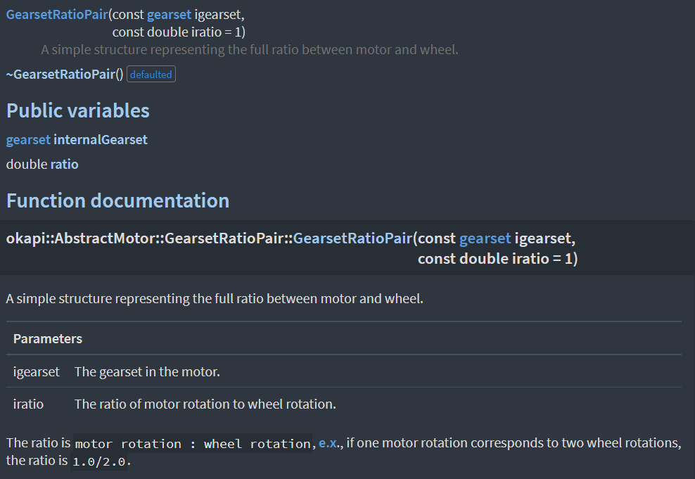

I have updated the line to this:
.withDimensions(AbstractMotor::gearset::green, {{3.25_in, 373_mm}, imev5GreenTPR * (60 / 36)})
However the turns are now around 70 degrees to every 90!
The distance between the two drive sides is 373mm and we are using 3.25" omnis. The gearing is 60 to 36 with 200rpm green cartridges.
It’s possible there is a bug with OkapiLib as this may be similar to:
What happens if you change it to .withDimensions(AbstractMotor::gearset::green, {{3.25_in, 373_mm}, imev5GreenTPR * (36.0 / 60.0)})
You may also want to explicitly use (60.0 / 36.0) in your as well to ensure that it doesn’t treat it as integer division instead of floating point.
I am not in a position to test this right now, however, is there any way of getting around this bug, eg. with the gearset ratio pair structure within okapilib? Thanks for the response.
@1408F I believe you must put the simplified ratio for
ChassisControllerBuilder()
.withMotors(
{1, -4}, // Left motors are 1 & 4
{3, -2} // Right motors are 3 & 2
.withDimensions(AbstractMotor::gearset::green, {{4_in, 11.5_in}, imev5GreenTPR * (5.0 / 3.0)})
.withSensors
ADIEncoder{‘A’, ‘B’},
ADIEncoder{‘E’, ‘F’, true},
ADIEncoder{‘C’, ‘D’}
.withOdometry({{2.75_in, 212_mm, 214_mm, 2.75_in}, quadEncoderTPR})
.buildOdometry();
note I may be wrong as i have never used okapi

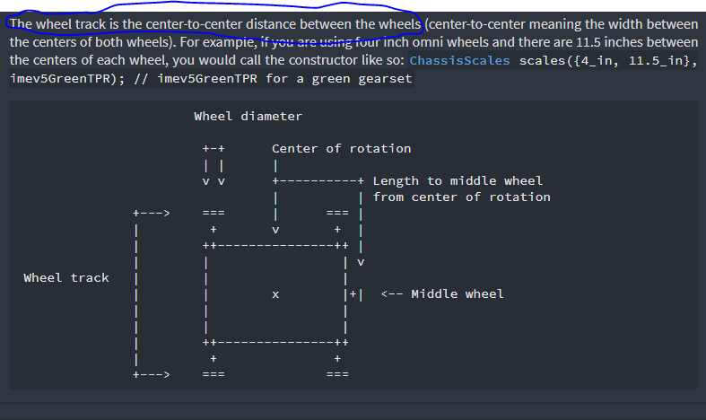

hey you used 373 mm which is 14.685 which is impossible with the vex system
Wheel track means the shortest distance between the center of the tire treads on the same axle. On vehicles having dissimilar axle widths, the axle with the widest distance is used for all calculations.
try to remeasure
that track is not possible
Can you explain why, because I can see for myself that the track is correct (I’m using a ruler)?
The vex system is made to use .25 .5 and .75 nothing else the only way you did that is if you have weird washers try 14.5 in or 15
Sorry but this doesn’t really make any sense.
Slightly vexed rant below, if you dare (not meant to be offensive).
rant
Have you ever used spacers or collars? Have you ever screwed two c-channels together and realised that the spacing is out because the metal is strangely not infinitely thin? Did you realise that omnis are actually 1.125" thick? 1.125 / 2 (eg. the centre) = 0.5625!
The vex system as you say, uses components centred around these measurements, however, chassis measurements such as wheel to wheel distance vary greatly since wheels do not have to be in a set position on an axel. Thank you for your input regardless, this issue is solved now, I will post the solution soon.
