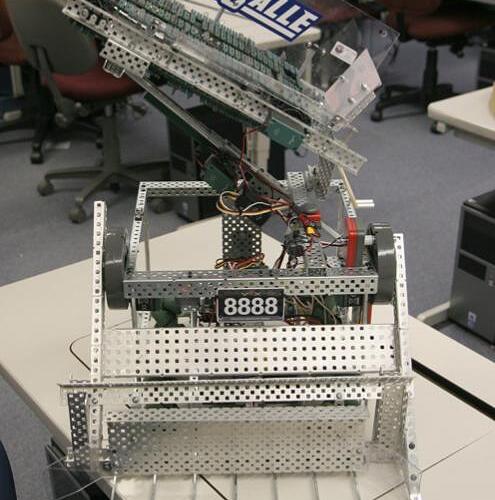

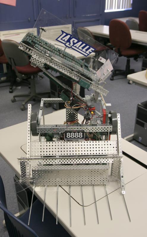

Here is a picture of last years programming skills robot. A single linear slide, powered by two motors, raised the conveyer belt assembly from horizontal to the position shown. Sacks were then moved up and dropped of the end into the trough. Not sure we could have done that with the new linear slides.
[ATTACH]7619[/ATTACH]
