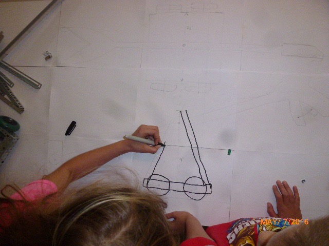

Hi Bailey and thanks for the questions. At first it appeared to be a simple question but then… Anyway here are some pictures. Eventually I’d like to use the Raspberry Pi for Visual stuff. Right now I’ll keep the 2 operating systems separate. After I’m comfortable with each OS then I might try to interface the two systems. So which language do you recommend for the Vex?
