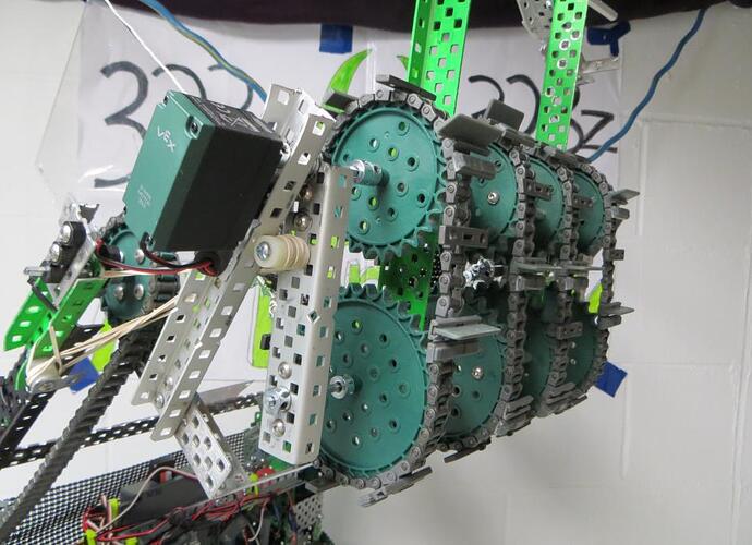

The intake has 2 393 motors on it. We stuck with a MASSIVE chainsaw intake. It is chained 3:5 for torque. The “spikes” sticking up are to hold the high goal objects. The bottom is lexan.
We have not done skills, but are hoping for 240 (if everything is done perfect :)). No programming skills yet. Autonomous is still a working progress.

Is there a reason why you kept the H-drive instead of put those motors towards the lift? Have you tried driving just without strafing and comparing efficiencies? With 2 motors, have you tried at 1:9 or something a bit faster? Are you ever actually going to lift(or fit) ~23 sacks at a time?
I see you guys kept a steeper lexan plate. Is there a reason why you didn’t use a flatter plate? (It seems more intuitive to me that a flatter plate would pick up better, but I’ve never actually built a steep plate before to compare)
Also I see you kept the flap-chainsaw intake, and that you at one point were trying a mesh intake. Is there a reason why you didn’t keep the mesh?

We really love strafing and it helps out a lot when stuck up in sacks, and collecting the sacks along the wall. Yes we have tried just tank drive VS holonomic, and we prefer holonomic.
We actually have picked up and scored 20 objects. We may go to a faster ratio, but I doubt it.
We did not have room for a flat plate. We tried doing it, but the angle did not get steep enough. What we have now works great. It’s not steeper than any other lexan plate we have done this year.
The mesh did not seem to grab the bags very well. We just changed our intake today, and it works SO much better than what we had on Sat. I think paddles and bumpers work the best.
