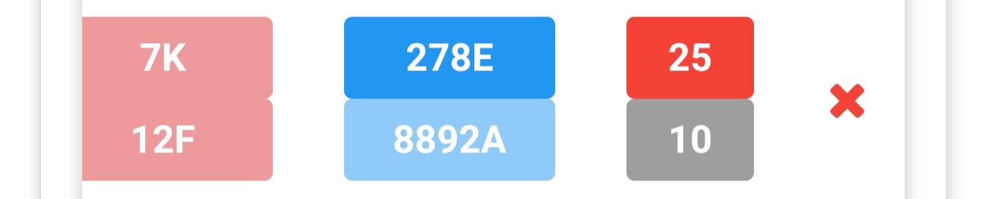

Xenon don’t forget that 7k had mecs in Turning Point. They sure destroyed us. It was my first year and my robot was awful though (qualified by skills). They got 3rd in skills iirc and went undefeated in science div.
My team went from 278e to 2990b.
