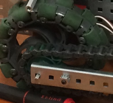

Is there a way to keep a 4-wheel omni base from being pushed and sliding short of adding another wheel to the middle of the other two.
#2
Slide screws between the wheel and the roller
#3
This is what is generally called having “locked omnis,” or a “bling drive.” It works great. But I would only lock one set of the wheels, unless your wheels make up a perfect square.
#4
@Got a Screw Loose is there a diagram or picture out there of locked omnis? I’m having trouble picturing exactly what that is, or even what a slide screw is.

Slide screw isn’t referring to a specific type of screw. It is referring to the action of putting a screw between the wheel hub and the small rubber rollers. I used the old motor screws and they worked well.
#7
You literally just stick a screw in the rubber rollers. I found that the old motor screws were too small to hold, but that could be due to my slightly more worn out wheels.
#8
Here’s a picture, if it helps. I just took it from another picture of my robot and cropped it, so it’s not of the best quality.

@Got a Screw Loose @Mark Finley @mattjiang
Thank you!!! I think we could use this on our robot.
