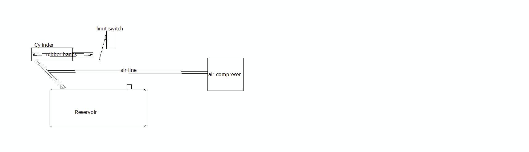

I didn’t think it was possible. This is mainly because there’s no way to track the amount of PSI during a match. With a good enough compressor, you can bypass 100 psi without knowing
All it wold take wold be a slender with rubber bands holding it in, and a limit switch. So as the air presser rises, the piston extends, even-truly pushing the switch.
Heir is a ruff drawing.
That’s a good idea, but I don’t think a referee would accept anything team-created as a means of ensuring you’re staying under the legal limit :stuck_out_tongue:
