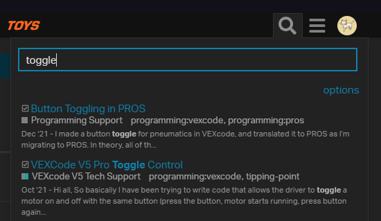

You can find more information about toggles by using the search bar:
Capture
