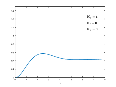

PID_Compensation_Animated
Here is this excellent PID animation. You can see in the beginning with only P control they stop between 60% and 80% of the way to the target. Then you can see how adding I and D affects the system.

Thanks a lot. This is very interesting. We will verify t hat.
Just added ki and it works perfectly without too much lag so far. We will further improve by fine tuning kp, kd and ki. Thank you everyone for great suggestions!
