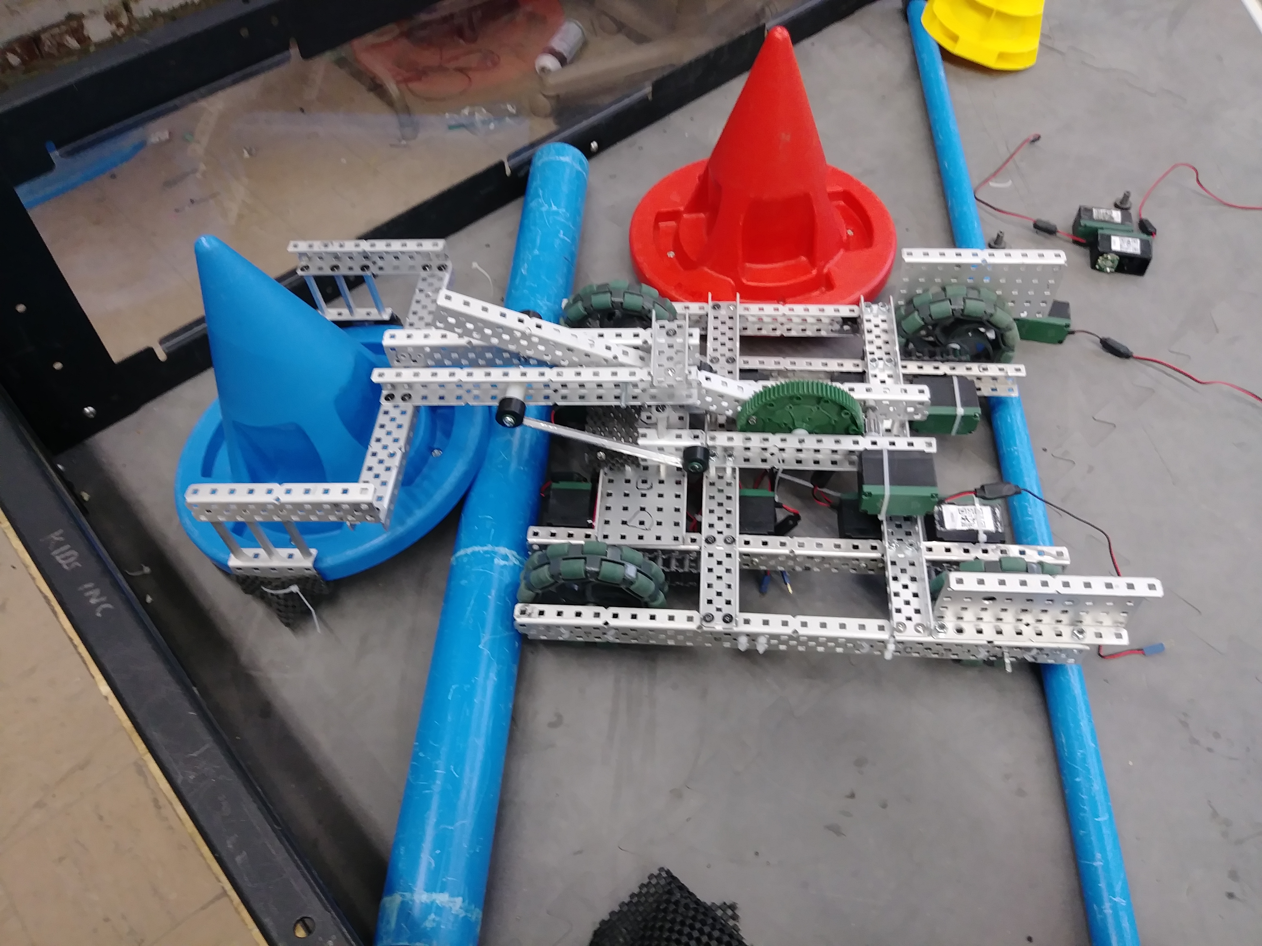

Basically, I need to make a MG Lift that uses one motor and it needs to be as compact as possible? It is possible for someone to post a couple pictures explaining how to do this. A detailed description should also work if you cannot provide pictures.

Run the gearing for the four bar in the middle of the bot, and have the front bars still be on the sides. Don’t make the bars any longer than 6” or 7”, and if you’re tight on space you can easily make the bars standoffs instead of c channel. Try to make the angle the bars rest at as close to 90* as possible, and try to make the actual movement the four bar has to do as small as possible so that you put the least amount of stress on the motor. The rest is up to you.

If you can, maybe look at my team’s mogo lift. It uses 2 motors at 1:5 torque, but you could probably pull it off with 1:7 with rubber bands.
My robot is the one tipped over, tell me if you need a more close up image.
The motor is in the center of the robot. It’s kinda like a 4 bar but without the front two bars, the back of the thing holding the mogo is being pulled by the motor and there are two support half-c-channels on both sides (3 bar? idk).
It worked really well for us.
