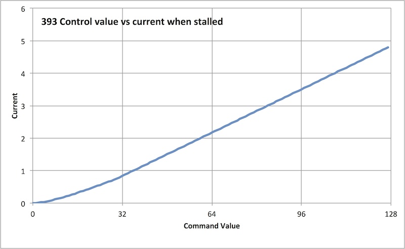

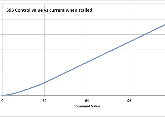

This shows the theoretical value of current for a given control value on the 393 motor.
[ATTACH]8990[/ATTACH]
The PTC safe current is 0.9A, so the theoretical maximum value is somewhere around 33.
Theory does not always work when it comes to PTC devices, try 30 and see what happens. I usually try to stay much lower.
Thanks so much Mr. Pearman. This graph is awesome… why didn’t I find it before…
Because I just made it for you.
The simplest way to calculate this is to just use Ohms law, I = V/R. The resistance of the motor winding is about 1.5Ω, voltage is the battery voltage multiplied by control value/127. The more correct way is to use the equations that vamfun and I created for the smart motor library (which is what I did above, although I tweaked it slightly) and use a motor velocity of 0 with varying command values.
And this is why we love JPearman
Exactly. Thank you again Mr. Pearman. Also, I did not know motor resistance was about 1.5 ohm… Doesn’t motor resistance vary depending on the spinning situation of the motor?
For stall current, you don’t have to worry about the rotation of the motors.
