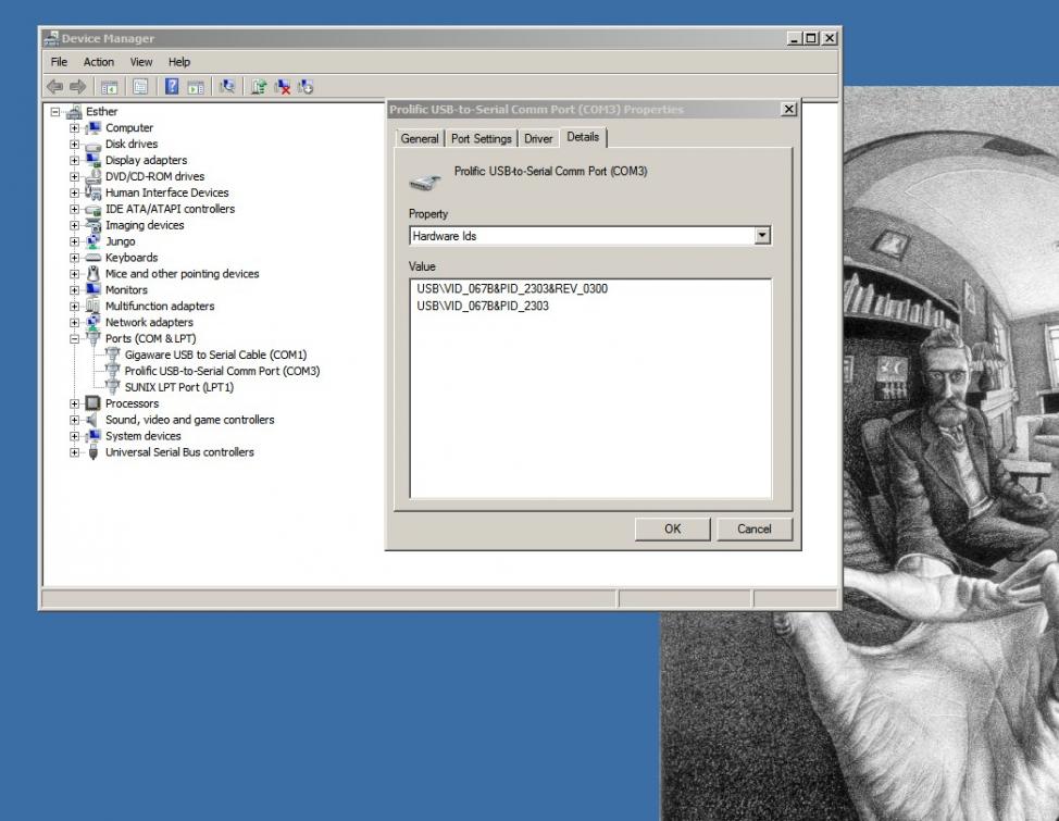

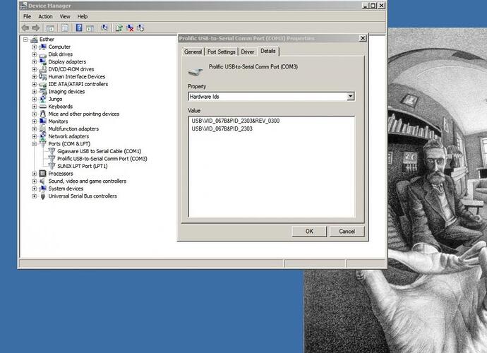

The “old” programming cables had USB->RS232 converter (the infamous prolific PL-2303) followed by 232->TTL conversion and some proprietary toggling of the RTS controlled by the PIC Mark mentions. The magic toggling controls competition modes when connected to a PC and also is able to put the master CPU into boot load mode. See this post.
The “new” programming cable (which I don’t yet have) implements the new VEX communications HID class so presumably has some other type of CPU doing the USB->serial conversion.
I also wish it were a little cheaper, say $35 (or find 9 friends and use the $29.99 bulk price?), I have been tempted to build one using an arduino but the cost would still be at least $25 plus connectors, enclosure etc. so it’s not really worth it other than as a programming exercise. Probably use this part
https://www.sparkfun.com/products/11098
AFAIK, you can do that with the USB A-A cable between your Computer and the VEXnet Joystick or between your Computer and the Cortex.
I don’t have the New Programming Cable, but I would guess that it has an FTDI USB-to-Serial chip rather than the PL-2303 USB-to-Serial chip.
The Old Programming Kit has Two Parts, the USB-to-Serial ( RS-232 Serial that is )with the PL-2303 ( mine has the PL_2303 XA / HXA chip, not supported under Windows 8 ) and the RS-232 Serial to TTL Serial adapter with the little PIC 12Fxxx chip… If your computer has an RS-232 Port Built In, you only need to use the Second Part of the Programming Cable Set, also, since the First Part is a common USB-to-Serial ( RS-232 Serial ) adapter, a different manufacture’s cable could be used.
