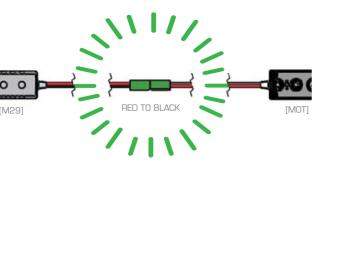

Grandpa3,
Glad to hear you system works with the default code.
In order to switch the spin direction on your motors all you have to do is reverse the connections between the motor and the motor controller 29.
See attachment.
I will move your post into the ROBOTC forum as they will be able to analyse your code.
-Eli
