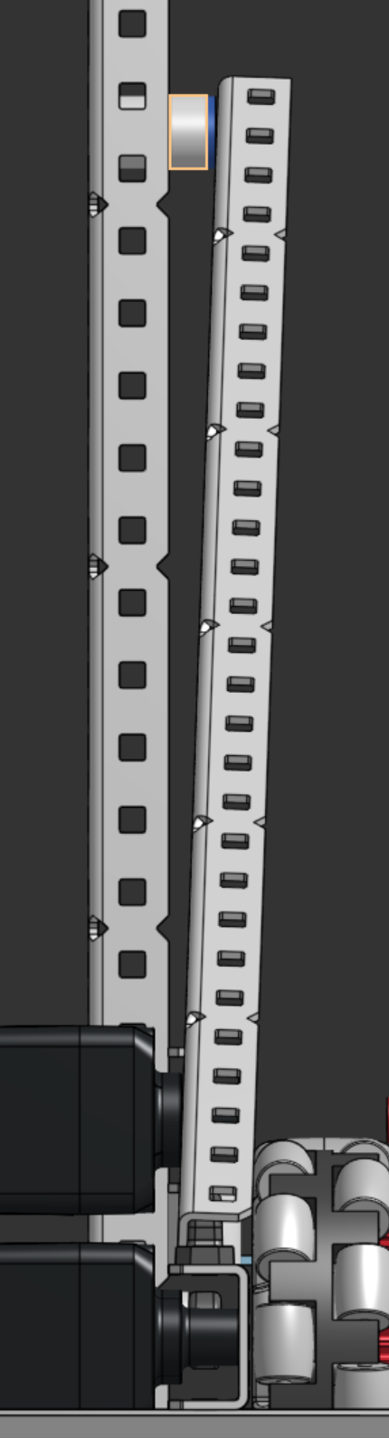

I was just cadding a push back bot on onshape with the v5 parts library and noticed that the pillow block is crashing out, is it just my cad thats just doing this? Are there any similar things happening on other peoples computers and is there a fix?
If you look at the model, you’ll see that the face of the pillow block bearing that you have constrained your c channel to is not perfectly perpendicular to the surface the pillow block bearing is mounted to. This is present in even the CAD model direct from VEX’s website:

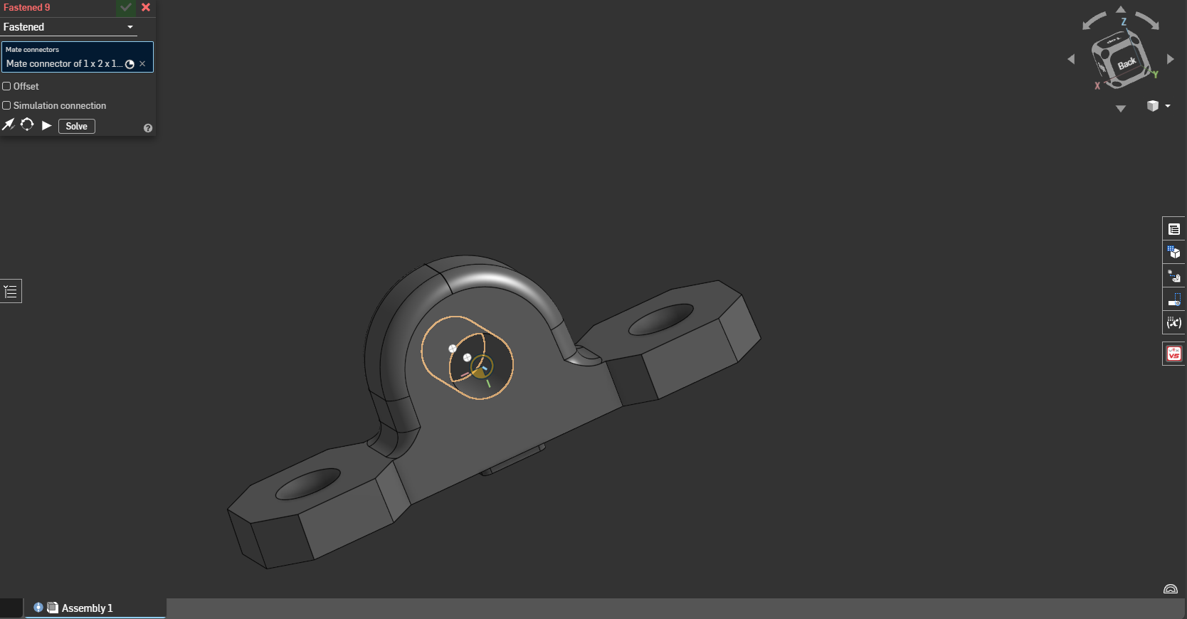

I’d suggest constraining your c channel to one of the mate connectors inside the cylindrical hole of the bearing and applying an offset, rather than constraining it directly to a mate connector that is on the side surface of it.
I also went through this issue, put your mouse inside the pillow bearing and hold shift and press the face u need as shown below. The c-channel should be straight after that

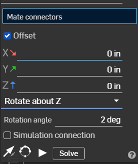

I was able to fix this by off-setting the mate by 2 degrees along the Z-axis
I hope this helps!
Sorry, I meant the Y-axis.
