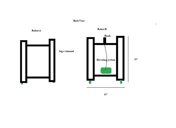

In order to simplify the design process, it was suggested on initial thoughts threads of the new game to start collaborating early for the late game elevating points. In this spirit, this thread would serve as an idea board to see what would work for multiple teams to easily achieve the elevating points with an open source interface, thus one can add ideas as well as modify and critique ones already posted to improve open source interfaces.
For the first idea put up I saw many good ideas on how to lift partners or have them drive up a ramp, but its hard to depend on the design of your partner to get the bonus (which includes where you could pick them up, would they let you pick up their bot, how heavy are they). Therefore, I suggest not worrying about if you can lift your partner. Instead design robot to lift itself which would simplify things in that you require one thing to grab on, you know how much robot ways, and you can do it every time no matter the partner. Say you put an eighteen tall pull up bar made of c channels on the back of your alliance partner’s robot. You grab on and pull yourself up using the wall for balance similar to toss up. In order to not tip your partner use a one time piston to release an anti tip bar(s). Even better use a winch on the back that hooks on and you also have a 18 in pull up bar on the back of your robot too and now the c-channels on each bot can help guide the robot lifting straight up just like a linear slide.
Pictures:
Side View Normal
[ATTACH]9245[/ATTACH]
Side View Elevated
[ATTACH]9247[/ATTACH]
Back View Normal
[ATTACH]9246[/ATTACH]
Bill of parts
Pull up bar structure:
4 1x5x35 c-channel
2 1x2x35 c-channel
Anti Tip Release:
1 single acting piston
1 solenoid
1 1x3x25 c-channel
2 standoffs
Hook:
1 1x5x5 c-channel
2 Rubber bands (to keep the hook at the top of robot during match before it gets pulled down)
Elevating Mechanism:
whatever your want, early season suggestion 1 motor winch and string.
Disclaimer: I have not read all the rules so some of these ideas could be illegal. Second you can use any design you want; this is just to simplify the challenge for teams that would like to discuss ideas on this thread instead of designing for a cooperative element of the game in isolation ways to pick up bots between 10-20 pounds with multiple different shapes and unique designs.

The idea isn’t to standardise robot designs, just to standardise the interface between robots. An example of an interface standard is USB - you can make all kinds of devices that have USB ports, and all kinds of devices that plug into them, but the standard means they can work together.

In order to achieve maximum elevation, the following “universal climbing mechanism” could be used:
note how the robot is balanced on the corner of the field so that both can be above the perimeter.
Because the robots both would start inside of 18, any robot could utilize this method, and any robot should be able to be lifted. Of course, the way it is accomplished can vary so creativity can still be applied.

Working off this idea, I was thinking about what common structure on the past robots that could act as the interface with which teams work off of when designing their robots to achieve the elevating points. With respect to ideas for elevating mechanisms that have already been discussed on the forum including ramps, pull up bars, forklifts, rack and pinion jacks and others just hinted at, I looked at what they relied on to work. These include drives with wheels certain distances apart to go up the ramps, cross bracing and vertical structures to be used as a pull up bar, raised chassis to slide fork lifts underneath, and top supports to hold a robot jacked up onto the other. I see the common component that they rely on to work as the 18" cube size restraint applied for most of the match this year. Since teams will need to be inside this restraint except for certain zones and times it is assumed that they will use the full extent of its size in which to put the functions of their robot. Therefore, if teams had 18" long support structures on their robot so that all dimensions of the cube were formed, a designer can rely on this to design how they can use those beams as places to attach, lift, or land on to get elevating points. Thus I propose, the interface to be that a robot has the shape of an 18" cube formed by cross bracing with which teams can interact to get elevating points. I think this would allow the ideas already expressed to work and provide a basis for multiple mechanisms to be designed off of.
tl:dr) In order to provide an interface that works with multiple elevating mechanisms, I suggest using the standard 18" cube size restraint as the general shape of the robot through the use of support structures. This will provide points to lift, grab, land on, and place a ramp under. What are your thoughts on using a the size restraint cube as the interface?
