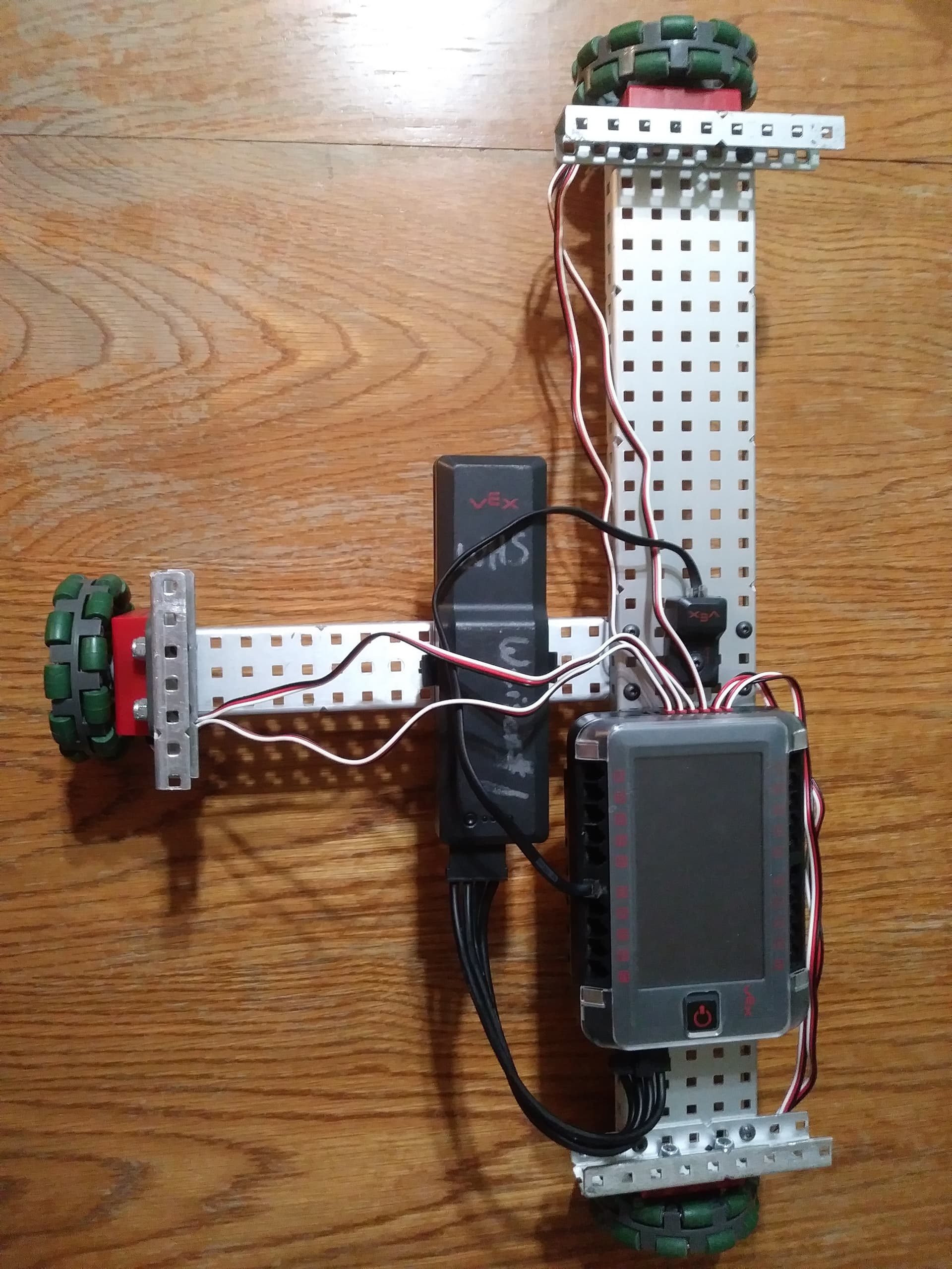

The situation: I’ve got a very simple robot that I’m using to try and program an odometry system. It consists of three old optical shaft encoders hooked up to 3.25" wheels, as well as an inertial sensor and, of course, a battery and brain. Its sole function is to be a training dummy to get an odometry system working under as stressful of conditions as possible. (Pic below)
Programming the robot is going fine, I’ve calculated all of the various thetas, arc lengths, etc. and have converted from local to global position change. On the final step, adding that change to the current position (robotX += globalXOffset), the code literally just breaks. Instead of adding said value, it simply sets it to 0 (Or, it seems, multiplies by a very small number, such that the result gets rounded to 0.)

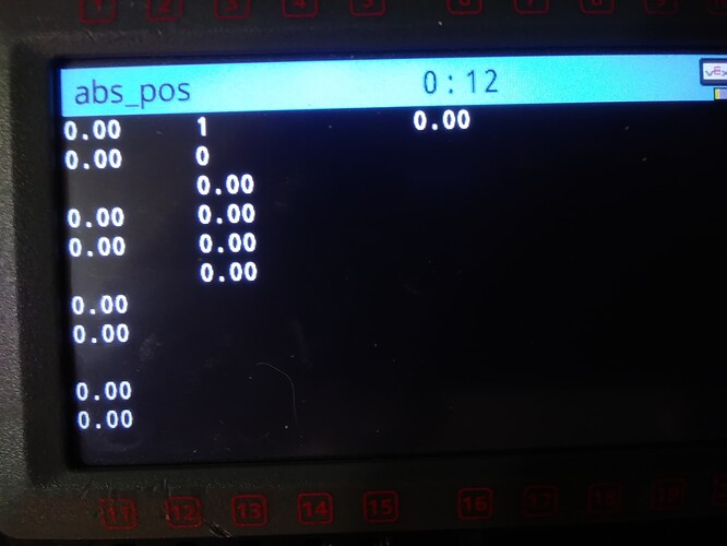

As you can see, the code does the same math, although there’s a fancy debug screen that’s being ignored in favor of a more relevant one. This debug screen prints values of robotX and robotY in pairs down the left side of the brain throughout the code, as well as the value of robotX before the function is called on the far right side of the brain. In between these values are the values of the math portions used, and each of them line up with what was predicted, showing that we really are just trying to add 0.00 to robotX, which was initialized as 5.

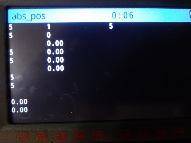

Picture for reference: first iteration of the loop:
Each of the pairs down the left side are 5, up until the last one (the one printed right after the += operator is used), which it then is shown as 0. on the next iteration of the code, the rest of the values on the debug screen update to 0:
I also tried not using the += operator, using robotX = robotX + test1; instead. It didn’t matter. Nothing I did accomplished anything but point towards that line of code as the problem. The name of the variable doesn’t matter. Doing robotX += 1; works as one would expect it to, and so does +=.1, +=.01, and +=10000000.
Ultimately, I have no clue why this is happening, and even copying the code to a separate VEXcode file doesn’t fix it. Does anyone have any idea as to why this is happening, and any solutions to fix it? I feel like I’ve tried practically everything (even got help from my brother who programs for a living), so what can I do?
I started odometry a little bit ago so I could be wrong, but when you are figuring out your theta for the heading, what if both (motor.prev) are the same(subtracting x by x)? Then you might be multiplying and dividing by zeros. I use the inertial sensor to find my heading, I put it into a similar algorithm to achieve my odometry. Take this with a grain of salt as I am fairly new to Odom.
Edit: Try printing your theta if you haven’t.
Edit 2: I quoted the wrong thing(I never post)
I think that you’re exactly correct! A theta value of 0 would result in the local offsets trying to divide by 0, possibly resulting in some sort of bit integer type limit, which registers as 0 on the brain. The X position would then add an absurdly large number to itself, causing the X position to overflow, thereby causing it to register as 0 as well. I’ll try adding the case statement for when theta = 0, and mark your answer as the solution if that works! Thanks again!
