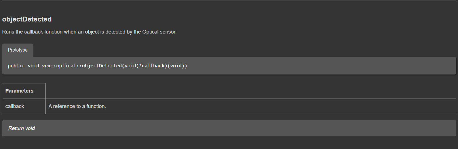

First, what do i swap blueball for in this line of code
Optical.objectDetected(blueball);
ok, According to the Vexcode API
in the line of code you are using, blueball is a Function, so when it detects an object then it runs blueball, the line of code you are probably looking for would be
(Optical.color()) this should return the color of what its looking at and then you can compare that to a range of acceptable values for the red and blue sides to know which side you are looking at, and spin the roller accordingly.
So do i not need Optical.objectDetected(blueball); ?
All that says is when an object is detected, run the function blueball, if you have a function named blue ball that will do somthing, then you need that, otherwise it is not something you need
