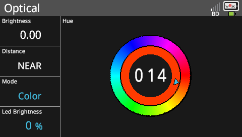

I suggest you experiment. Go to the optical sensor dashboard and see what range of hues you read for the objects on your robot, try with the optical sensor led on and off.
optical
The range of hues we consider red is 340 to 20 degrees (40 degree range). If you find your ball is slightly outside that range, then read hue directly and set the boundaries accordingly.
