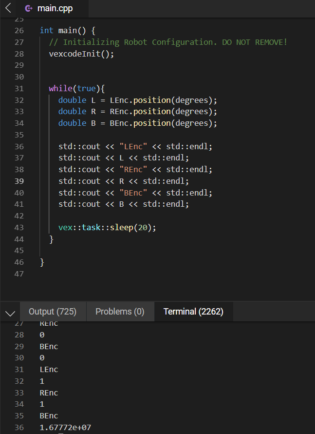

I have been using the 3 wire optical shaft encoders for programming. Today I noticed that sometimes they would output a very large number when they were kept perfectly still. After printing the encoder values to the terminal it turns out the left encoder sometimes gives a reading of 1.67772e+07 (always this number) after 5 iterations of the loop and then returns to outputting 0 (as it should).
This was originally only happening to the left encoder however I have now seen it happen from the back encoder and right encoder as well. The number is always 1.67772e+07.

Here is a picture of my code including the terminal
Note the encoders don’t always spike like this. I would say one in 3 times.
