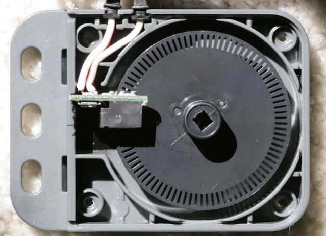

The OSR contains a rotating disc with slots in, here’s a photo.
[ATTACH]8466[/ATTACH]
Two sensors detect the slots. Each sensor will out put a logic high or low depending upon whether IR light can pass through the slot or is blocked. The sensors are slightly offset by one half slot so the change from blocking or passing IR will be at a different time.
Software that uses the output of the two sensors is interested the edges of the signal, the changes from low to high or high to low. For each slot that passes there will be four distinct states.

It’s very inefficient to keep checking the state of the two encoder inputs, what we do in practice is to allow the state change (the signal edges) to cause an interrupt to the program (an interrupt causes the program flow to change by jumping to new program instructions). To fully decode the encoder states we need interrupts to occur on both the rising and falling edges of the signals, I’m pretty sure that the PIC did not have this capability and could only detect one edge of the signals, this means that at most 180 counts per revolution could be detected. ROBOTC used a trick where every time it sees an interrupt (remember this is on the PIC) it will increase the encoder count by two, this keeps code consistent with the cortex and also gives a direct mapping from encoder counts to degrees. Early versions of EasyC did not support the quad encoder (this is actually a guess), they had the function block GetEncoder which only used one of the two signals coming from the sensor. As only one signal was used there was no directional information and the count rate was half, 90 counts per revolution.
The cortex has the ability to allow either edge of the sensor inputs to cause an interrupt. ROBOTC can now use the full 360 count per revolution resolution. EasyC introduced a new block called GetQuadEncoder that also uses two inputs and (AFAIK) also returns 360 counts per revolution.

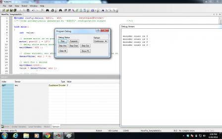

I am not sure about a code to display the encoder counts. I am new to programing and not sure that i have that code right. Any code that you code give me?
I gave you code yesterday, however, you do need to change it for your particular setup of ports.
Turn on super user or expert menus.
Compile and download the program, you should be able to see the encoder counts in the sensors debug window. Enable the debug stream to see the printed value I included in yesterdays code.
You need main battery power for any of the sensors to work, not good enough to power the cortex with the USB cable.
This is where i got. but i still have no reading.
Are you plugged into digital 1&2 (not analog 1&2)? Is the white wire towards the center (vexnet) of the cortex? Is main battery power good?
