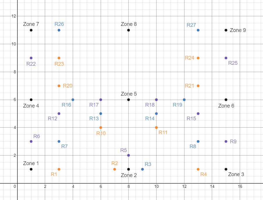

So entertain for a moment a bored high school senior. Upon hearing the prompt of this year’s game, my first question was “What color configuration scores the most points while traveling the least distances?” This might seem trivial at first (I certainly thought it was), but is actually a pretty interesting problem.
I tried to create an algorithm to solve this problem, and so far I’ve come up with two solutions which I’ve shared below. All of the code, pathing, data, and visualization can be viewed through my github. I apologize in advance for the messy code.
Refer to the field diagram below for my naming scheme. For titling purpose, row one refers to the bottom row, row two the middle, and row three the top.
Solution 1 - Closest Zone: Orange, Purple, Blue
see: ColorScoring\Project1\Source.cpp
My first approach was to find the distance between each riser and each zone (*see: ColorScoring\Project1\dist_annotated.csv) and calculate the minimum distance needed to travel to a zone while still preserving the given color combination.
For this solution I did all my calculations in arbitrary units where 1 unit = 6 inches
An evaluation of all 6 row color combinations spit out this:

for riser-zone assigments see : ColorScoring\Project1\rowZone.csv
It can be read as such: for the OPB solution, riser 1 goes to zone 2, riser 2 goes to zone 2. riser 3 goes to zone 8 and so on

For this solution, I implement what some call a greedy search. From the starting coordinate (36,66), the program looked for the shortest path to score using the following algorithm:
  1. Find the closest riser of a given color from the robot’s current location
  2. Find the closest riser of a given color from the first riser
  3. Find the closest riser of a given color from the second riser
  4. Find the closest zone which is either a) in a row with a stack of the same color or b) in a row without any stacks
  5. Record the distance needed to travel that path.
The program would then run through those steps for each riser color. Then chose the shortest path. Running the algorithm for each zone returns the following path (which is visualized nicely thanks to mathplotlib for python):
NN-Path
This path has a total distance of 1303 inches( see: ColoredScoring\Pathing\Output.txt).
note there are some choices the algorithm makes which I can’t explain. For example, step 3 is suggested as R21>R24>R11>Zone6, but I’m fairly certain the optimal path would be R11>R21>R24>Zone6.
You’ll notice that the greedy approach ends up hurting us in the end because as we take more and more steps the robot has to choose longer and longer paths to get to its destination.
This is not necessarily a bad thing, especially at the beginning of the season where most teams will not clear the field anyways. In fact steps 1-4 are actually quite reasonable, so running steps 1,2,3,5, might be a good way to get a fairly high score when you inevitably get the “bad team” which scores poorly.
Please note THIS IS NOT THE OPTIMAL PATH TO SCORE ALL RISERS, in fact, I’d estimate this path is 30-45% longer than the optimal path due to heavy cross-field travel done in steps 7-9.
