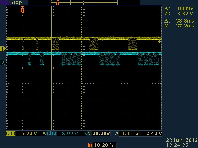

The next issue we face with ROBOTC is the way its proprietary communications protocol works. As discussed before in other posts, there is a 2000 byte buffer that debugStream data occupies before being sent to be displayed. ROBOTC will request a new chunk (I’m avoiding calling this a packet so as not to confuse with the USB packets) of data for display in the debug window at periodic intervals. It does this between also requesting all sorts of other information such as motor status and global variables. ROBOTC will ask for up to 250 bytes to be sent for display in one message, sometimes it will ask for several 250 byte chunks in a row before asking for other status, but the overhead of the protocol does not allow for anywhere near the theoretical maximum serial throughput to be reached. Here is an example of communication from user processor to PC showing debugSteam packets. This is in a similar format to the previous traces, it only shows serial data going from user processor to PC, it does not show the ROBOTC data requests.
[ATTACH]7534[/ATTACH]
As before, the yellow trace is data from user cpu to master cpu, the blue trace is the data out of the joystick and half the baud rate of the yellow data. In this example, two small packets are followed by three 250 byte debugStream packets. Note that data is flowing from the joystick for approximately 50% of the time available dropping the effective baud rate to something like 57600.
So we determine the maximum data rate for ROBOTC to be perhaps 5760 characters per second minus the overhead used for other messages, a safe speed would probably be about 3000 characters per second.
