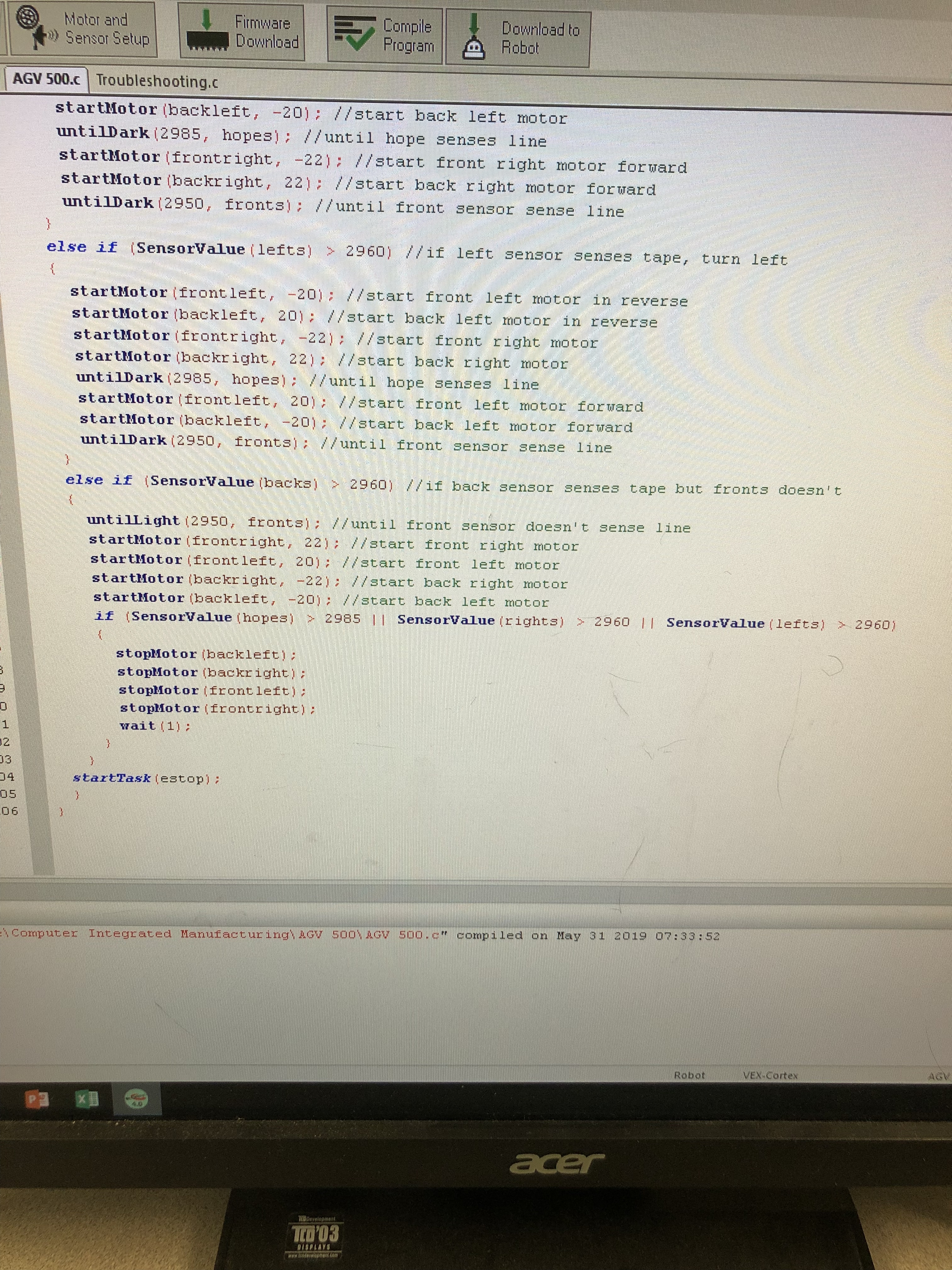

I tried the while statement and it didn’t work so I switched if for an if statement and if still didn’t work. My teacher said that an the code “break” will bump the code out of the if statement but I’m not sure where if should go. This is the code and I’m having issues with the bottom section. I put the stop motor thing in to see if that section was even triggering and it was but it still wasn’t doing what I wanted it to.image
Would it be possible tk post your entire code? You can do this by dragging and dropping the robotc file into the browser when going to post.
And wrapping it in [code] tags!
This is the first half of the code. It wouldn’t let me upload the file because of the file type.
Can you cut and paste the code in? that screen is pretty much useless…
Only partially correct. break will break out of a loop (for, while, do...while) or switch statement, but does not interact with if directly. So it will jump execution out of the if block, but it will also jump it out of the enclosing loop. If you want a similar statement that jumps back to the start of the loop and starts a new loop cycle, continue can do that. It’s like break in that regard, but instead of terminating the enclosing loop, it just acts as if the program had reached the end of the loop normally.
As for the last case in your if statement, I don’t think the problem is between choice of if and while. I’m not entirely sure because I don’t know quite what you’re trying to do, but I think I’m seeing other errors in the program logic here.
