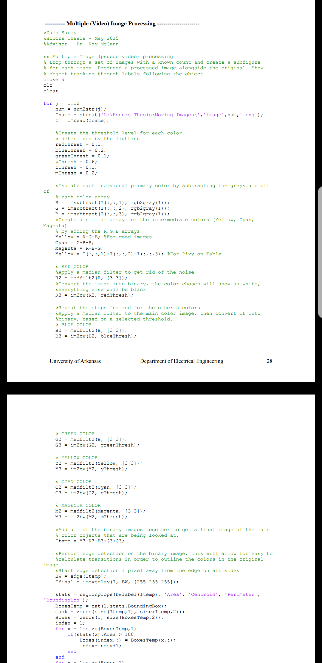

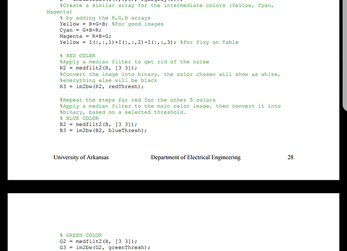

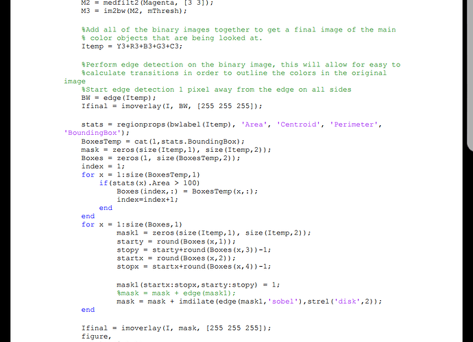

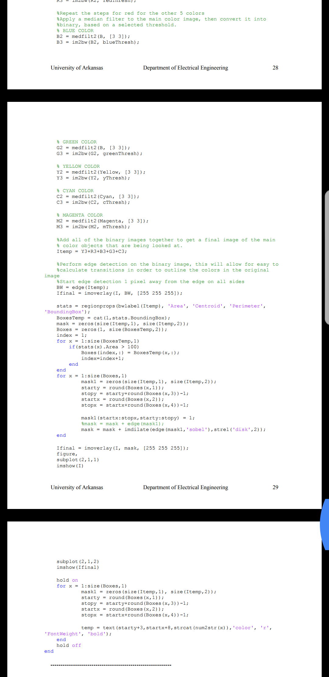

As I said multiple times in my post and in the title, this was an early model. And I couldn’t have gotten too wrong seeing as I was just putting the code in the article into layman’s terms. Attached is all the code provided in the article
@antichamber again, this is not real pixycam code. And it’s not an early model. This is a student’s version of an attempt to emulate the pixycam algorithm. The real algorithm shares some similarities with what you’re describing, but it really is an extreme oversimplification.
Let’s say for instance, I was “completely incorrect” If that were to be the case, not only would the creators of the pixycam have thrown away all of their development, but you would be counteracting official statements from vex saying that it’s a “hue based object tracking system” which if you have read my explanation, or the thesis I linked, you would have noticed that the system’s detection system is completely based on hue. Am I wrong in believing that a system that tracks objects based on their color is in any way similar to a system that tracks objects based on their color and or simple patterns of color?
