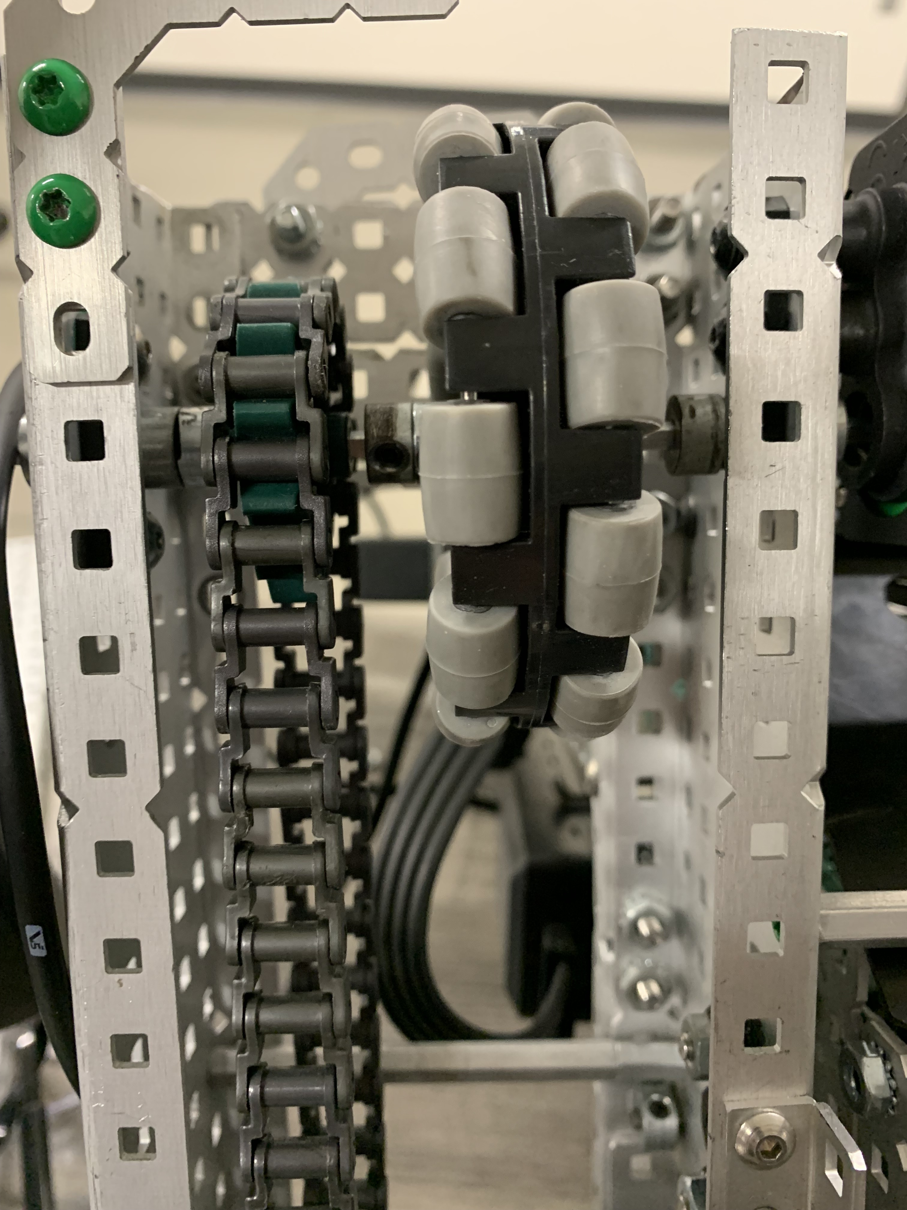

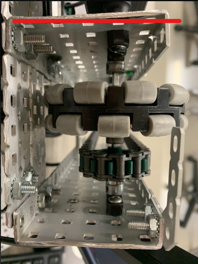

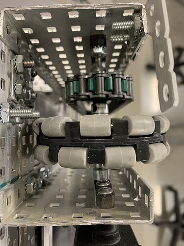

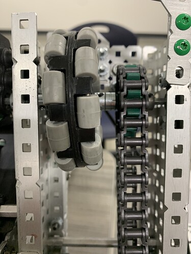

I feel like unless there is something electrical with V5 that causes this, I believe this is a mechanical issue. I highly doubt this is a programming issue. Would it be possible to post some pictures of your drivetrain wheels and axles?
Follow up question to add to this post, did you use bearing flats?
Yes we are using bearing flats
Yeah I can do that here’s them
that might be your problem, that c-channel is bent (this could just look bent because of the picture). you can get a lot of friction if the two c-channels are not parallel with each other

THe pictures indicate a fair amount of build quality issues - warped c-channels, no bracing on top part of drive train… So if sides are not parallel with one another, you are going to have shafts rubbing against one another. One side is out of alignment with other - so looking at two dimension problem with alignment. It will all add up. So quick check is to see if wheels spin freely and equally when axle detached from motor. If one comes to sudden stop compared to others, a good indication excess friction is the problem. There should be very little resistance when spinning wheel and axle.
