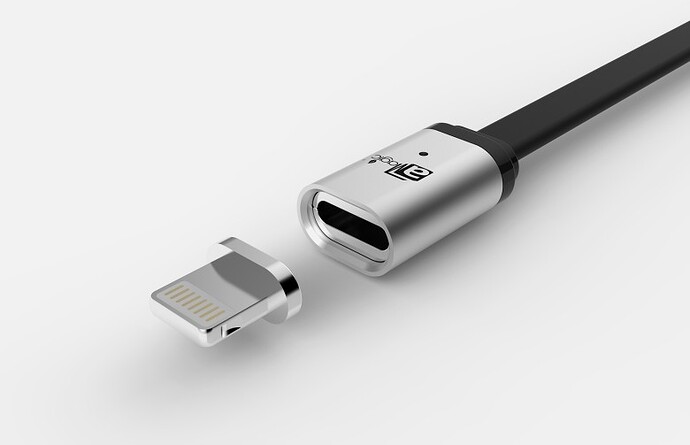

If they go to the extremes of desoldering components off the PCB, I would remove damaged micro USB port and stick an iPhone magnetic adapter in its place.
I took apart one of those magnetic Lightning adapters and, while it requires some soldering skills, it is not impossible to find and connect wires to GND, Vcc, D+, and D- traces. Data is not exposed on pads by the way. You have to peel off the shell to get to them.
But soldering to power is easy - you just cover all other contacts with kapton tape before soldering.
