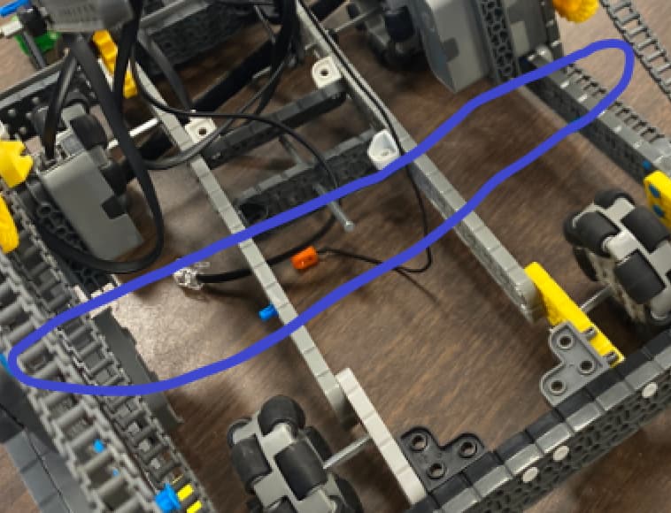

Our robot is unstable
We have tried to stabilize the robot with axles but it still wobbles.

First, how did you do this:
that dual motor mount is not supposted to be able to fit there…
To fix your unstableness, I would try bracing the drivetrain by adding a 2x20 beam (or whatever) over here:
This will help keep the wheels from falling off and add stability.

Based on the image you provided, the wobble you mentioned is due to a relatively weak frame, especially for the top of your robot (your robot’s frame is lacking some of the supports it needs to be perfectly stable).
To fix this issue, add more plastic beams connecting the parts of your robot. For the gap that seems to be for your catapult’s movement, you can support it by strengthening the existing frame around it.
