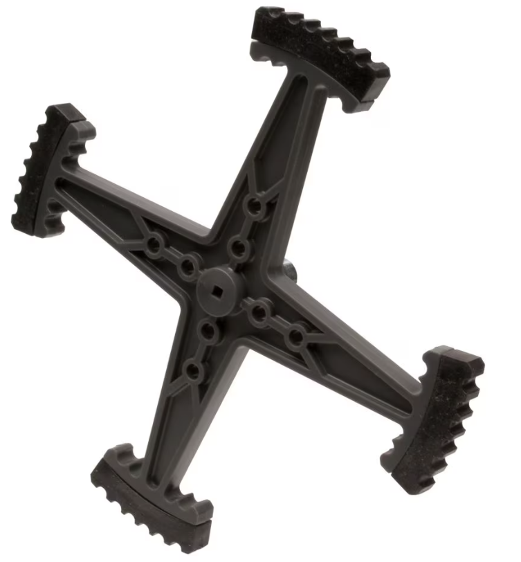

Since no one has mentioned it yet, I’ll throw it out there… Wheel Legs

Sadly no longer legal I believe.
I believe these are now illegal… had that thought too :smiling_face_with_tear:

They are still legal, just discontinued.
Note: the 5" wheels are still legal too.
Thanks for the correction, not really sure where I got that idea. I’ll be interested to see how many teams use them for the first time in a long time this year.
