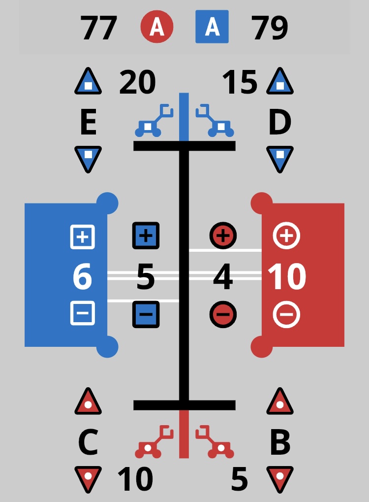

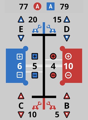

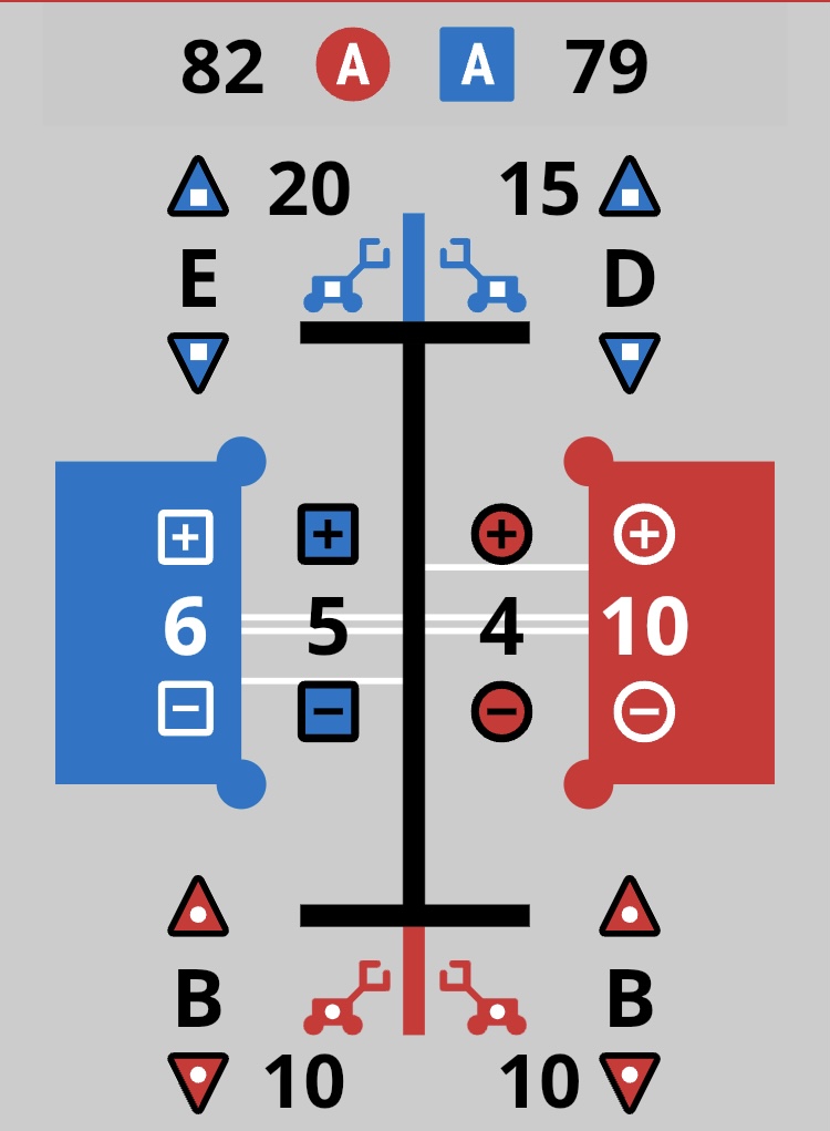

Both examples are compared to this theoretical match where the blue alliance is winning but just by a bit:

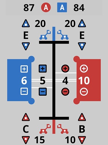

Situation #1:
If the red robot at C lowers itself to B, due to how ties are managed in the scoring, red would now be winning:
This one stems from the fact that ties are handled like 1,2,3,3 instead of: 1,2,4,4. While this can be changed, I believe this one is good how it is.

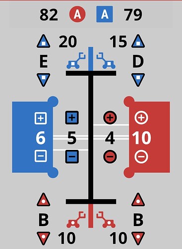

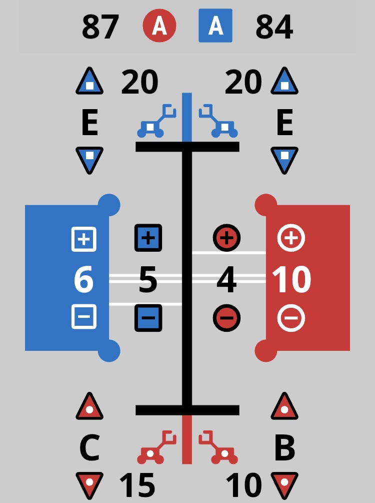

Situation #2: if the blue robot at D goes up to E, due to the way ties are handled, it might give blue 5 more points, but red now gets 10 more points
This one stems from the fact that ties are handled like: 1,1,2,3 instead of: 1,1,3,4. Which in my opinion is a very easy and smart change to make so that scoring higher for your team doesn’t make the other team score higher too
