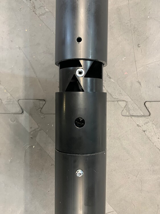

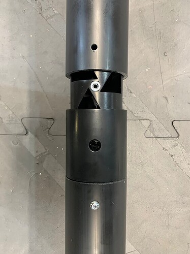

When I connect my long beams to the center joiner and the 2 “tripod” parts, I do get the ~94.25" center-to-center span.

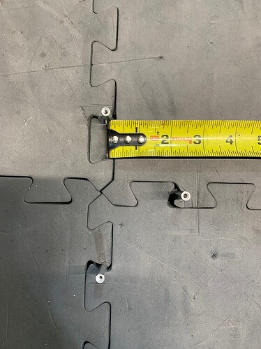

However, I can’t seem to get that assembly to mate to the base plates and stand-offs. See:
Leading to:
If I attempt to mate the ends to the plates. I’ve avoided above, instead, by removing each of the stand-offs on the center-side plates so that only the 1 standoff on the half-line remains. I then can get things “attached” to all the base plates (with 4 fewer screws). But now the short barriers no longer run completely parallel to the field perimeter, and the 21.89" measurement from the wall to the SB is more like ~23".

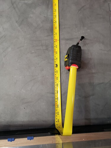

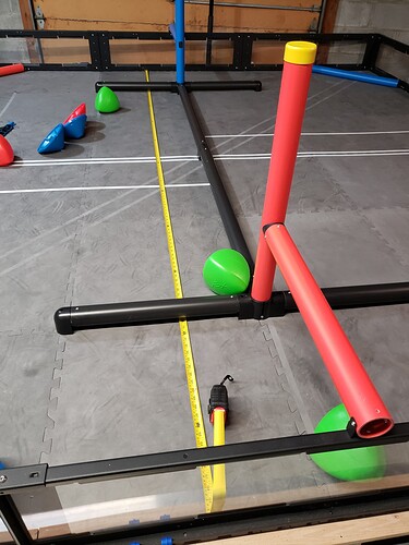

Further, if we add the measurements going across the field: 21.89" + 2.38" (PVC diameter) + 91.88 (Long Barrier length) + 2.38" (PVC diameter) + 21.89", we arrive at 140.42", which does seem to match to the 140.5" inside field measurement specified by page A9.
However, my inside field measurement seems to be closer to 142" (using the metal field perimeter). It seems square, as best I can tell, and centered on the tiles.
We had the same issue with our field. Another somewhat related issue was that when attaching the goals the cross bar seemed to be a little short causing the tiles on one side too lift. Has anyone else encountered this?
Had the same puzzling thoughts when assembling the pipes on a “classic” mint condition certified pre-owned metal field. Nothing seemed to align or match. The trick for me was aligning the short side bars to the standoffs in the three plates and bolting them down. Then I literally pulled the whole assembly as hard as I could so the middle piece aligns with the… middle. The foam tiles are fairly malleable. Then to my surprise everything came into place and the walls look straight. I get almost 141" across now. Mine too was at 142 originally.
