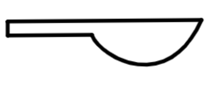

Ok, I see your intake is on a hinge perhaps? If so, I recommend you cut some polycarbonate sleds like this:
Thank you all guys you’ve been very helpful, I’ll try to corporate all these ideas, however, I think I found the problem, I used to screw the C-channels very tightly with bearings which increased friction . So, I’m thinking like maybe( kind of sure) I should replace it with a shaft so that the other C-channel can move easily hopefully It’ll be stable and persistent enough, I’ll also add the sleds and try to decrease friction as much as possible .

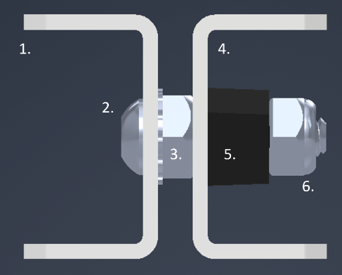

Screw joints have a lot less friction than axles. A screw is a circle, and a shaft is roughly square.
For screw joints, yes you never tighten the nylock nut all the way, but you leave a gap about 3/32 in wide. This decreases friction and for an intake the slop caused by it is negligible.
Axles have a lot more friction because with them, you’re trying to fit a square peg in a round hole. There ends up being a lot of friction on the corners of the axle. Also, unless it’s a high strength shaft (even then if you’re intake is heavy), unless rotated, the shaft will start to bend under the weight. Screws however are thicker at their narrowest, making them stronger.

(VEX Joints - BLRS Wiki) Screw joints involve the c-channels (or wheels for drivetrains) rotating around a screw. There are various designs for it, but the image above is a basic one.
An axle is a joint that involves the two c-channels rotating around your average shaft (I call it an axle). I don’t have a picture, but it involves something like: shaft collar - spacer - bearing flat - c-channel - spacer - c-channel - bearing flat - spacer - shaft collar

So you mean the hole between the 2 bars is attached with actually a screw not a shaft
I mean just like the prototype you sent me
