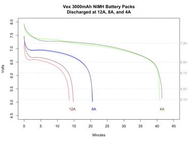

all batteries are over their rated voltage directly off of the charger. I can’t find it now, but someone (jpearmen?) posted a graph of the battery voltage over time. The voltage quickly drops to around 7.2 and stays around there for a long time and then drops off quickly. It flattens out near 7.2 for most of the time the battery is operating; that is why it is rated at 7.2 volts.
here is a link to tons of battery info:
https://vexforum.com/wiki/Quazar’s_Battery_Load_Test
[ATTACH]7496[/ATTACH]
To be clear i did not make this it is from the vex wiki. All credit should be directed to the author of the page linked above.
hope this helps!:slight_smile:
Yay for actual battery graphs! For auton code we purposely drop the voltage to get to where voltage doesn’t drop as quickly to make sure that the routines are as consistent as possible.
How do you accomplish this consistently?
It actually says right in your link. This was actually done by Quazar. It is a very well-done test.

I suppose the best way to monitor the voltage is by using the LCD, we just use a volt meter to check the voltage. It’s pretty easy to hit the part of the graph where the slope levels out. Just stall motors so that the voltage drops quicker.

Another idea: Create a simple circuit with a switch, resistor, and volt meter. 1103 had one of these at Worlds, and used it to decharge batteries before recharging them. A similar concept could be used to decharge the battery until it “levels off.”
This has the benefit of not overheating any motors…
