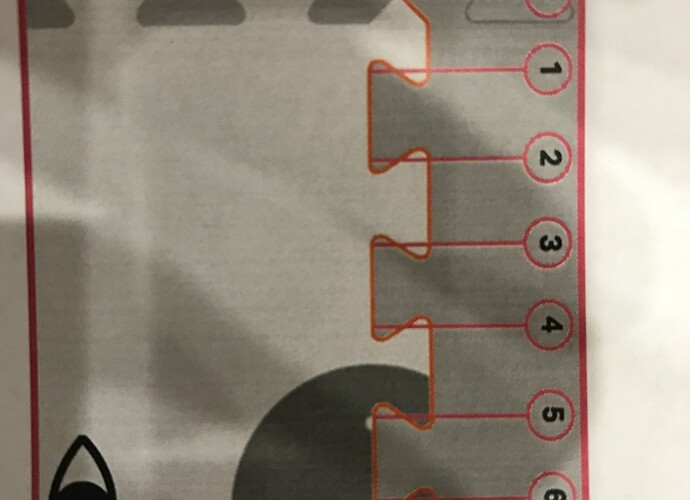

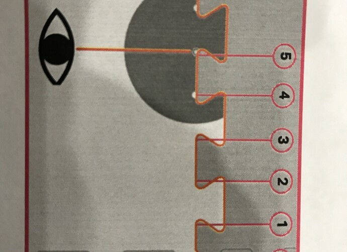

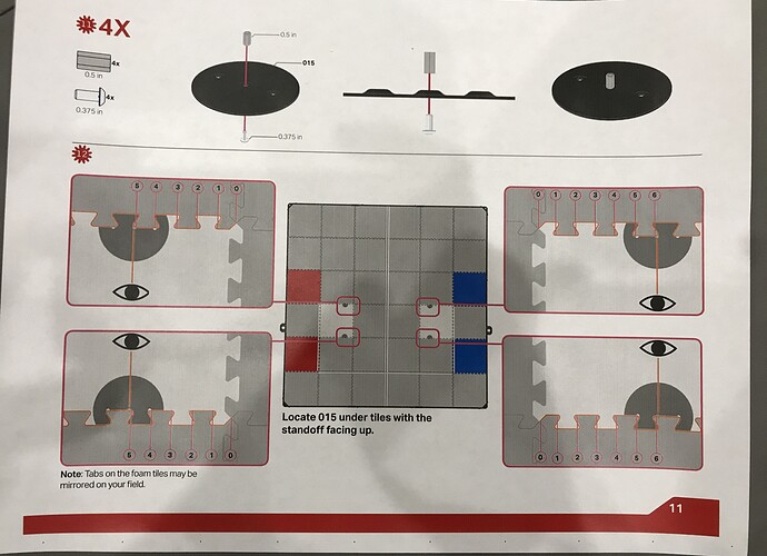

So I was assembling my field today and noticed something odd in the assembly instructions: they appear to place the parking platforms closer to blue than to red, as seen in the instructions here:
This can be seen better when the opposing sides are zoomed in on:
Red Side:
Blue Side:
This was confirmed upon assembly when the platforms measured ~1in closer to blue than to red.

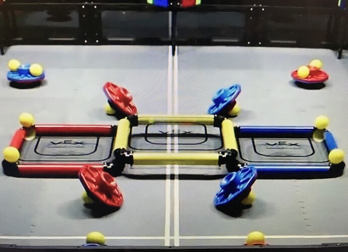

In fact, the Platforms can even be seen to be off center in the game reveal!

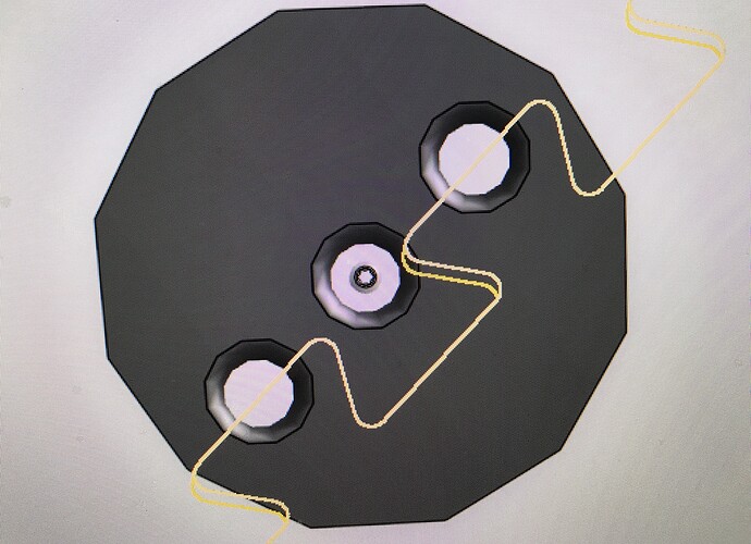

In the field cad they are centered but the standoffs go straight through the tile!

Teams should really prepare for the parking platform to be closer to the blue OR red. Not every event till set every field perfectly. If your auton is sensitive to the variation, you should verify the distance, by some quick visual aid, before you begin the match or skills run.

You might consider cutting two tubes a little shorter instead. That’s what I would have done in VEX’s place.
Yeah. It’s not hard to correct all of it (like seriously ,drill the two platforms in different locations). I feel like they just got lazy//didn’t expect the people setting up the fields to be able to identify which side is which (thus screwing it up more).
That’s an even better solution. Once you know the limits, it shouldn’t be hard to adjust to get it however they want it. I think this was a regrettable oversight that got missed a lot in the design and testing process.
