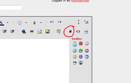

Use the code tags button and it will look nice like this:
Your code here
[ATTACH]8620[/ATTACH]
