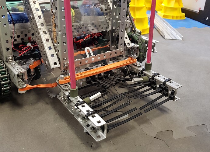

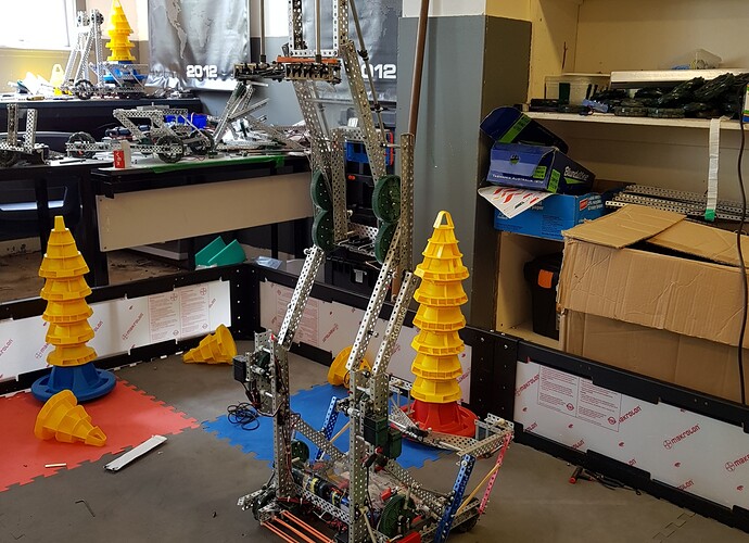

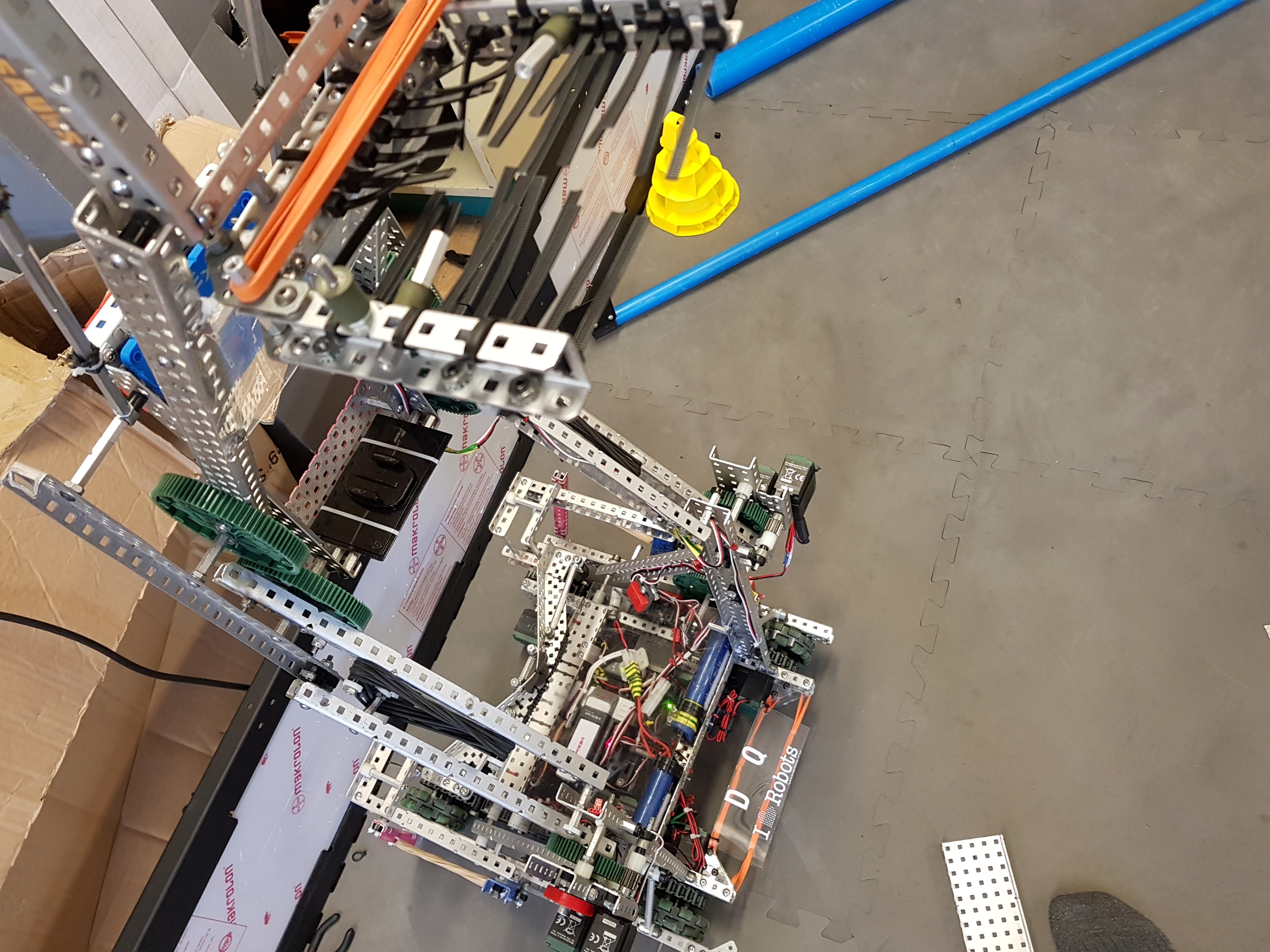

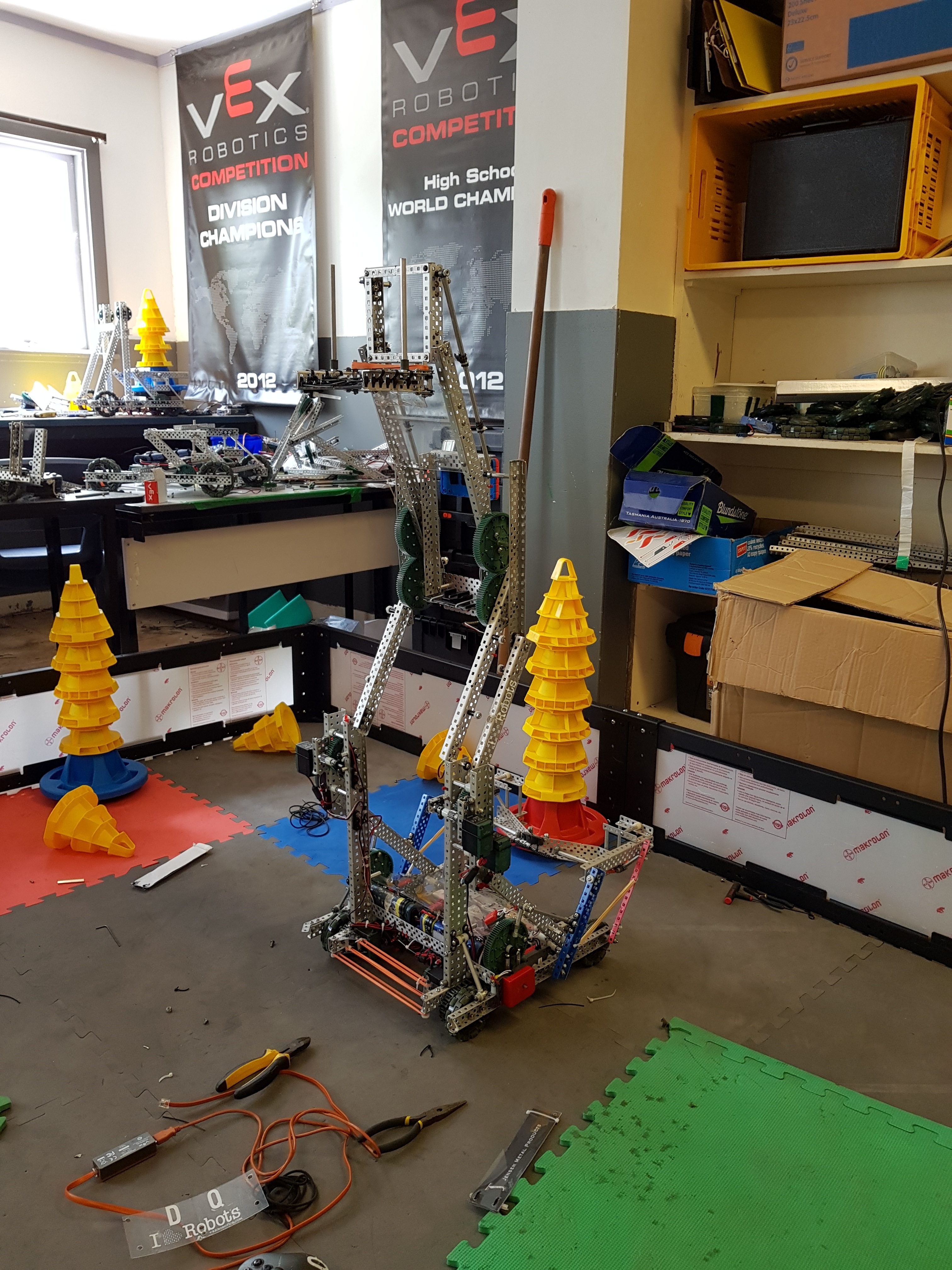

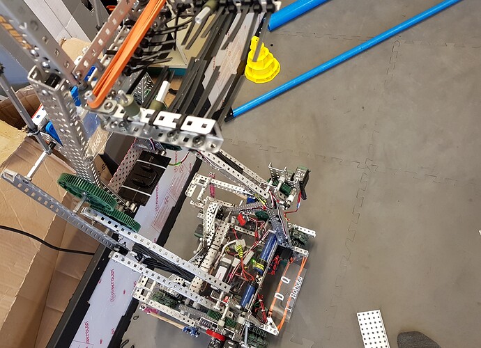

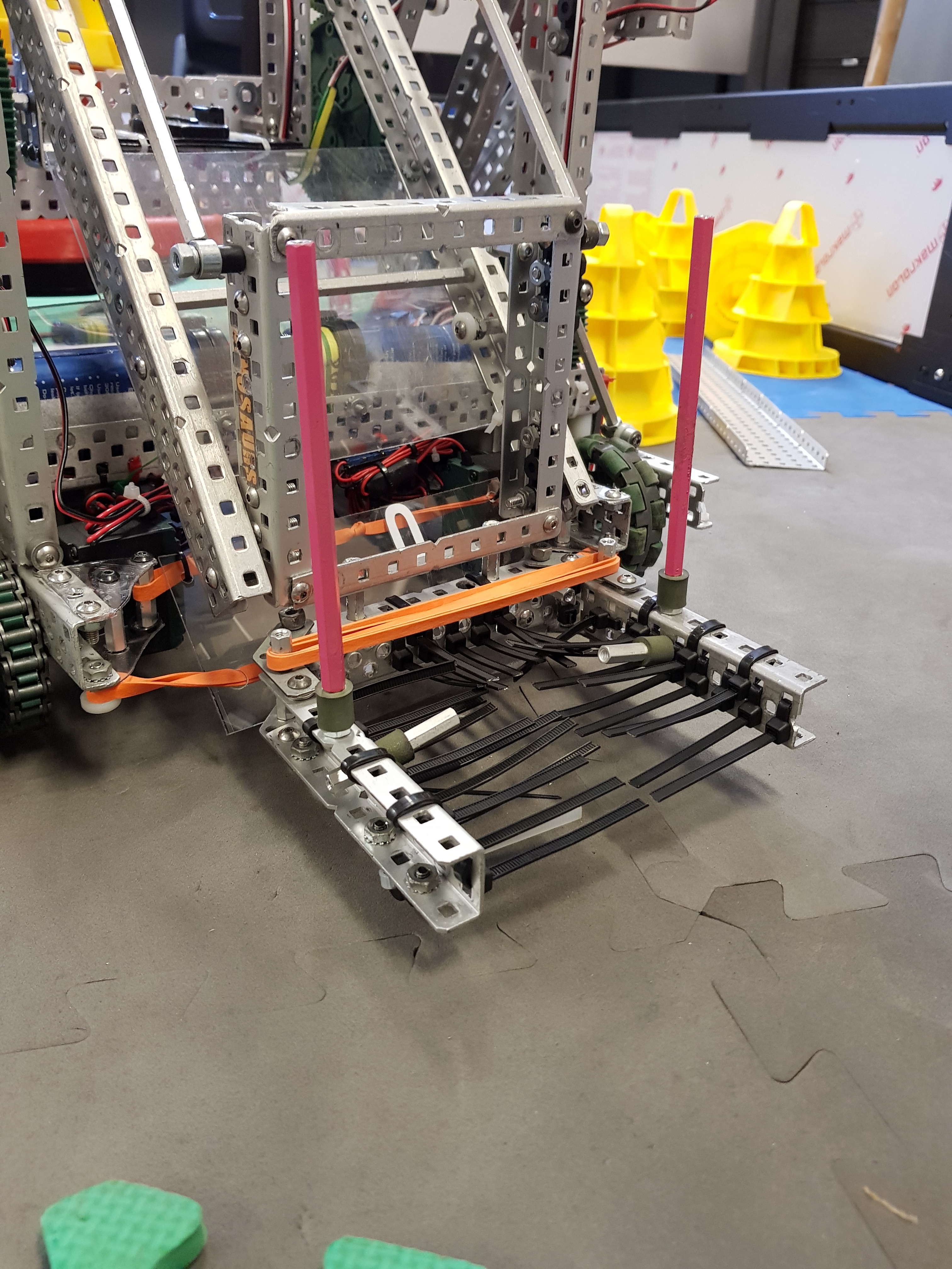

A couple of months ago in collaboration with 21S, we had created a ziptie intke that was shared onto the discord server before. The intake at the time was built for externals and had worked really well. It did take a lots of patterns and different methods to make it work reliably.
I have included a few pics and vids of it in action.
Do keep in mind that this was back in September and there was very little driving done before taking these vids.
2900D / 21S

Except for the part when it doesn’t :wink:
