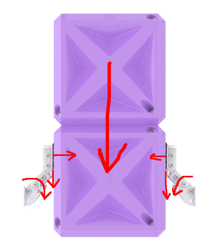

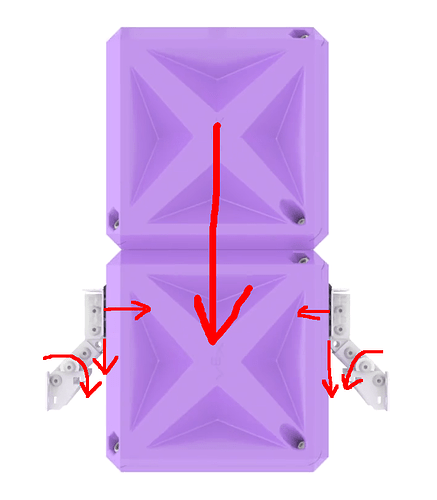

Do any of you know what parts they used to make the passive intake shown.
I am thinking that it might be a combination of gussets, short C channels and mesh.
Many Thanks

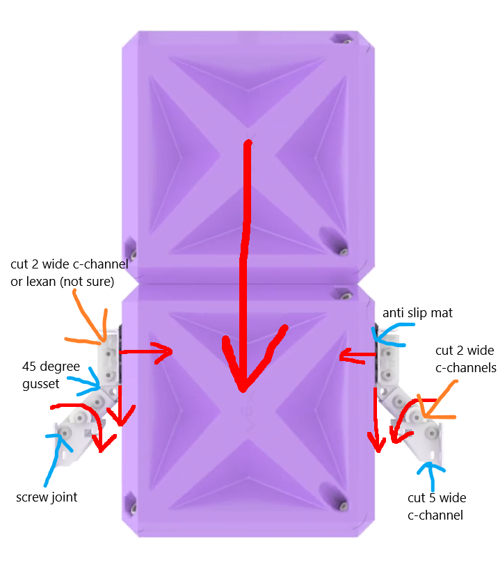

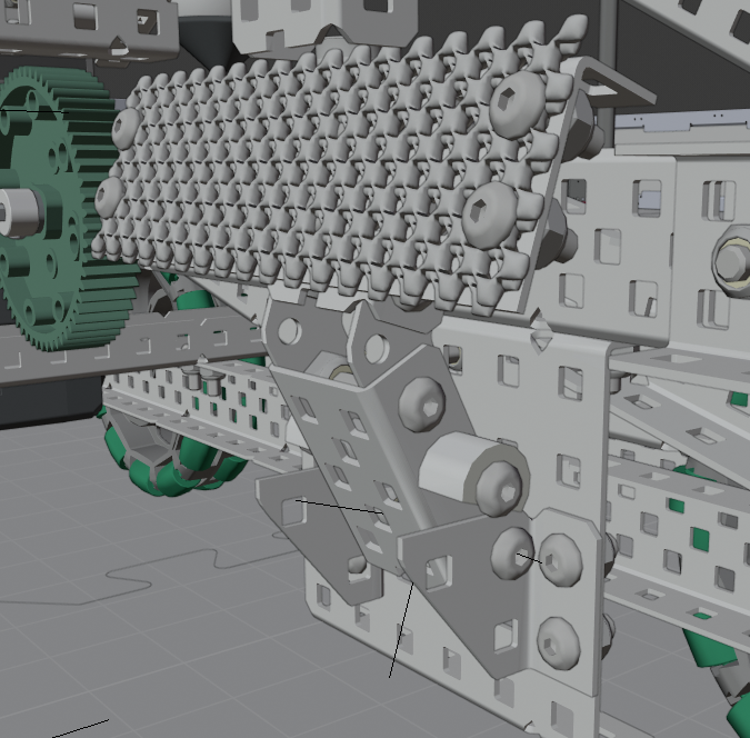

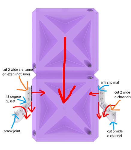

though our team isn’t making passive intake. from the picture i see:
im not sure if this is what u wanted though
Also this is just an animation, meaning it was never tested in the real world. This specific design might need to be modified, before it works properly. The takeaway you should from this design is the idea, not specifically how it is built. It is fine if you build this specific deign, but it is important that you also know how to design things your self.
