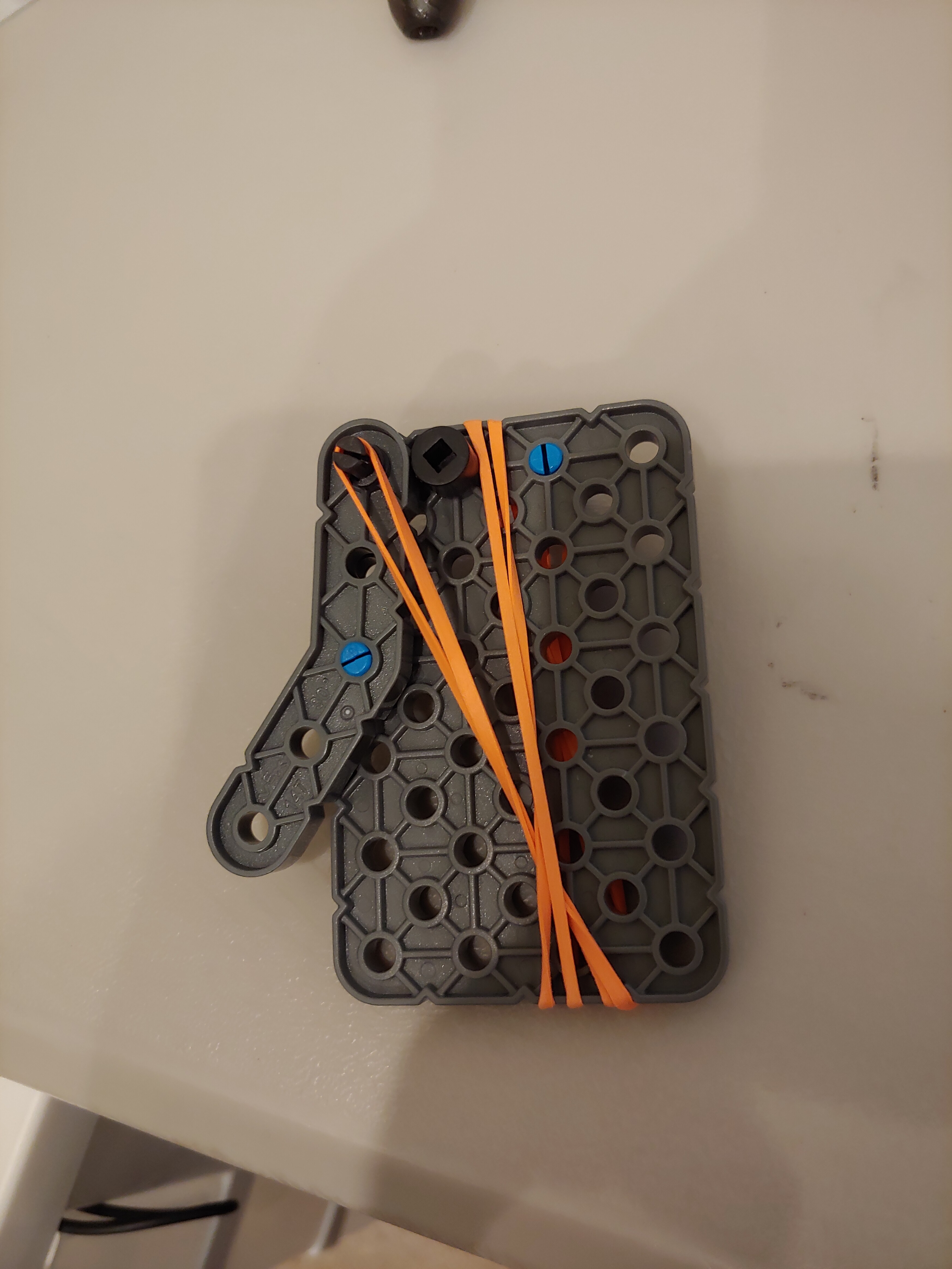

There are two main ways I know of to do this (there are probably more out there, and I think we’d all appreciate hearing them if you have one to share).
For the first one, you have a sort of bi-stable / over-centered clamp that starts up at the beginning of the match. It has a good number of rubber bands. It is built as such so that when you hit the goal, it pushes the over-centered or bi-stable clamp so that it tries to go to the other position, consequently latching on to the goal. I’m pretty sure that with the proper technique, you could get a pretty solid clamp on the goal.
VEX IQ mock-up of the concept

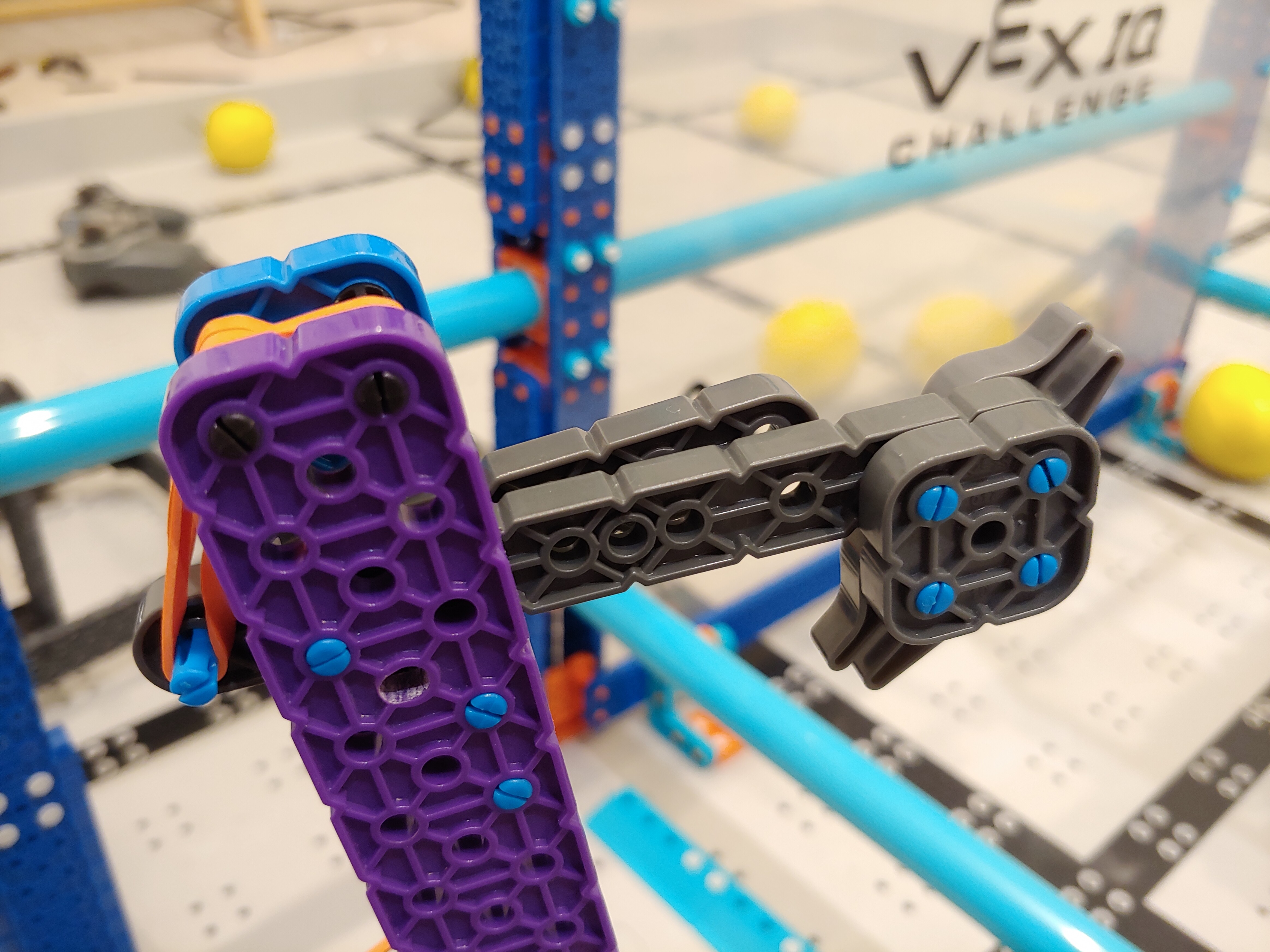

The second one is like a gate-latch. If you’ve ever seen those gates where you lift the latch to open it, and then just push it closed to shut it because it latches shut, that’s how it works. It’s a little hard to describe the actual concept, so here’s a VEX IQ mock-up.
VEX IQ mock-up
