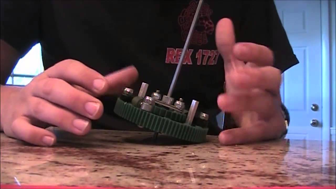

Here is a noteworthy improvised pawl:
However, it might not withstand the high torque loads required for this year.
I’m thinking hs sprockets + standoffs or pawls that are the hs 12 tooth gear with fixed rotation.
