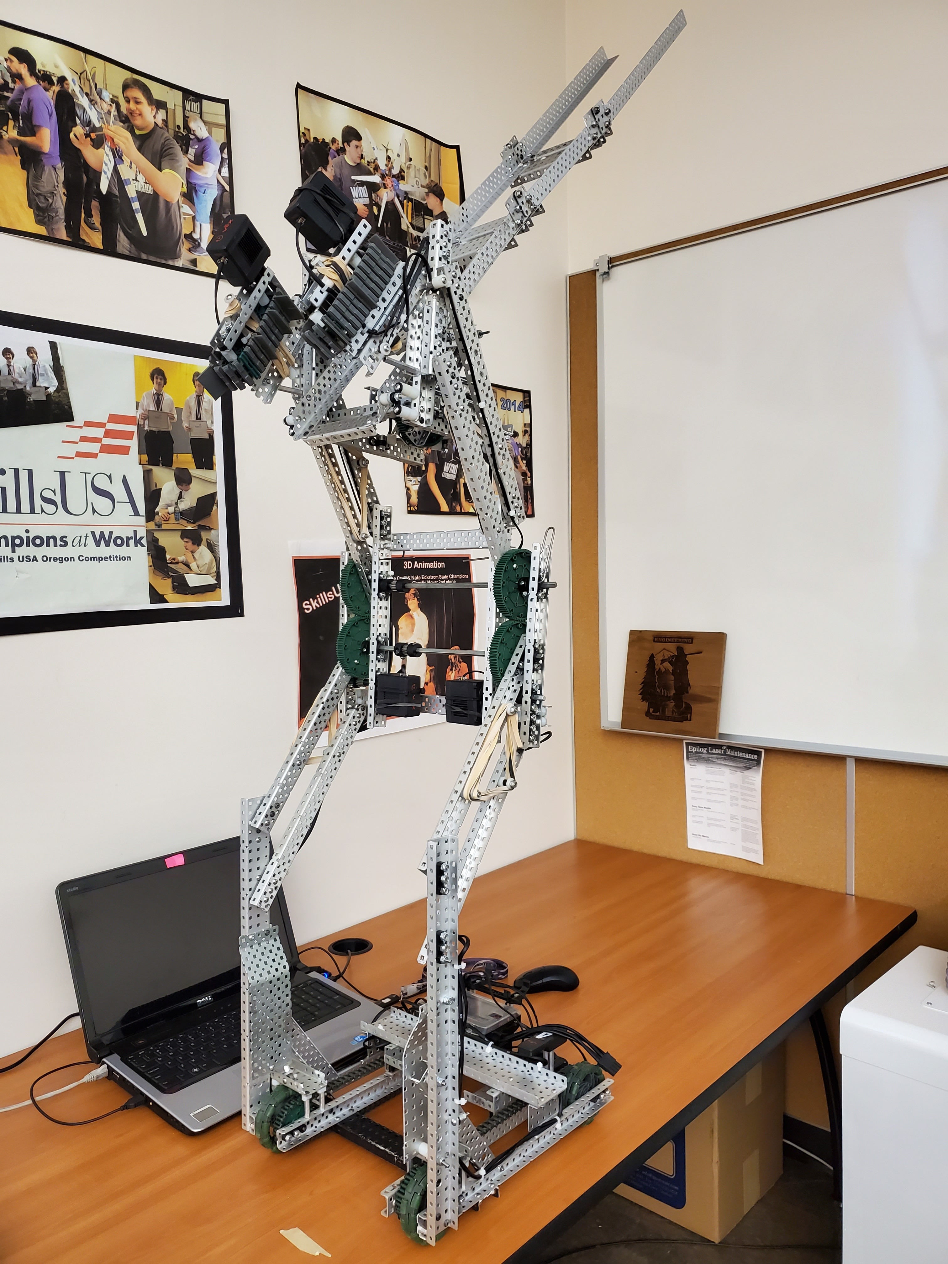

Hey guys, new to the forum game. But I have a slight issue and was wondering if anyone could provide assistance. Shown in the picture is our gear box atop our reverse double four bar. It may not be so apparent in the picture, but the entire thing is leaning backwards. I’m assuming this is because the tray extends backwards and the weight is causing it to do so. How do I counteract this? I’ve put bearings on each joint with nylocks. It seems to be a combination of the entire arm leaning back from where it pivots at the towers. Any and all help is appreciated.

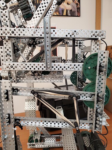

It would be helpful if you sent us a picture of where the towers are connected to the base
20191021_142941
This is the best I have at the moment. I can put another one up in a couple hours if needed.
I haven’t built a DR4B before, but have you made sure that your lower 4 bar has the same length or bars and mounting points? The picture makes it almost look like you’re just a square off. Otherwise I would just make share it connects to the frame securely at a right angle.
Edit: upon further inspection, make sure the lower 4bar is parallel. It looks like you might have varied where the joints in the bearing are (a more side on view of the lower 4bar would be helpful)
Also, your banding seems off. Check that when the arm goes down segments of the triangle get bigger and when the arm goes up segments get smaller.

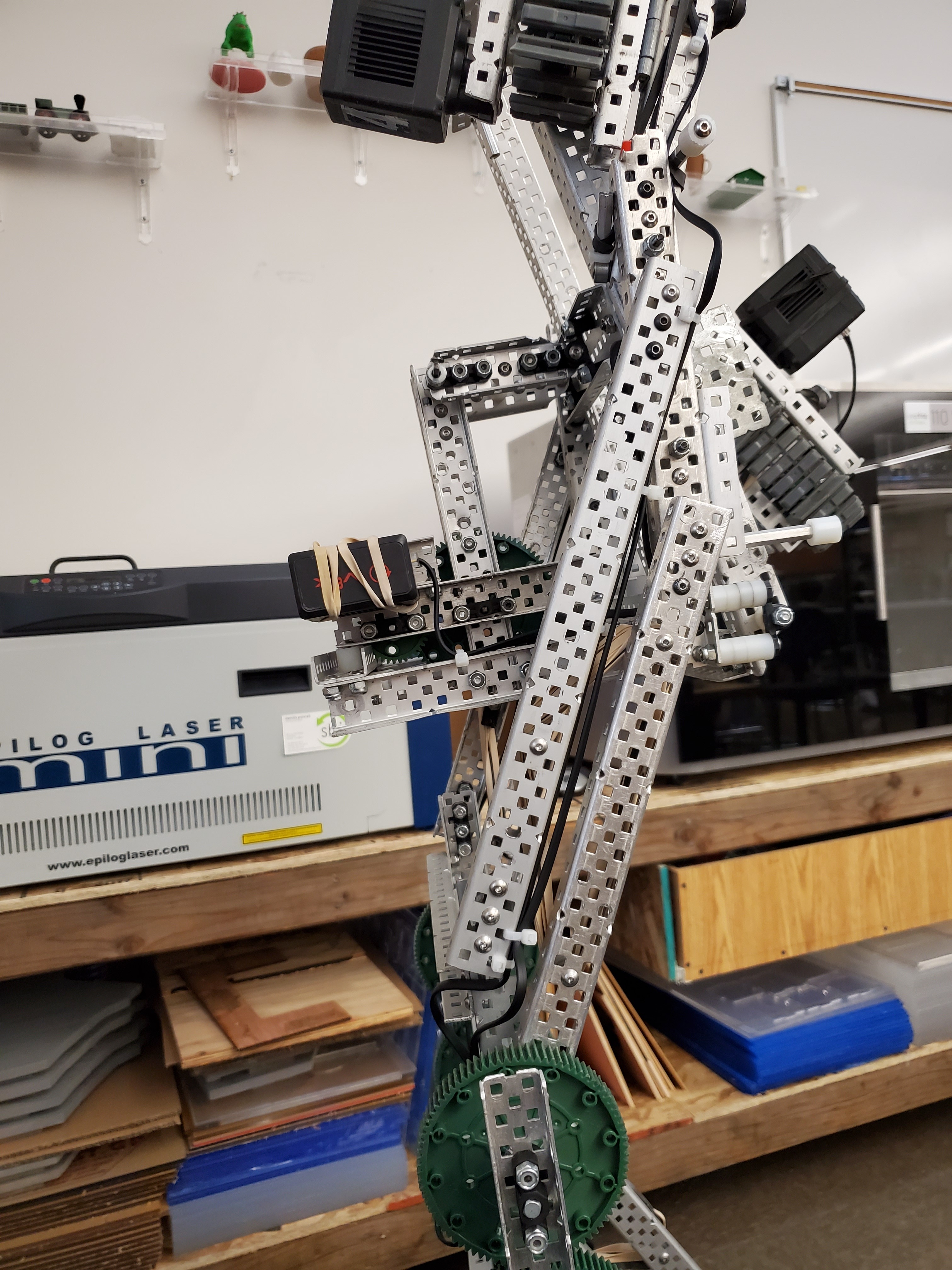

IMG_6988
E: the bottom bar of your first 4 bar is one hole too short? Shorten the top bar of the first 4 bar or move the joint
this also is a problem with double 4 bars they tent to tip to a degree

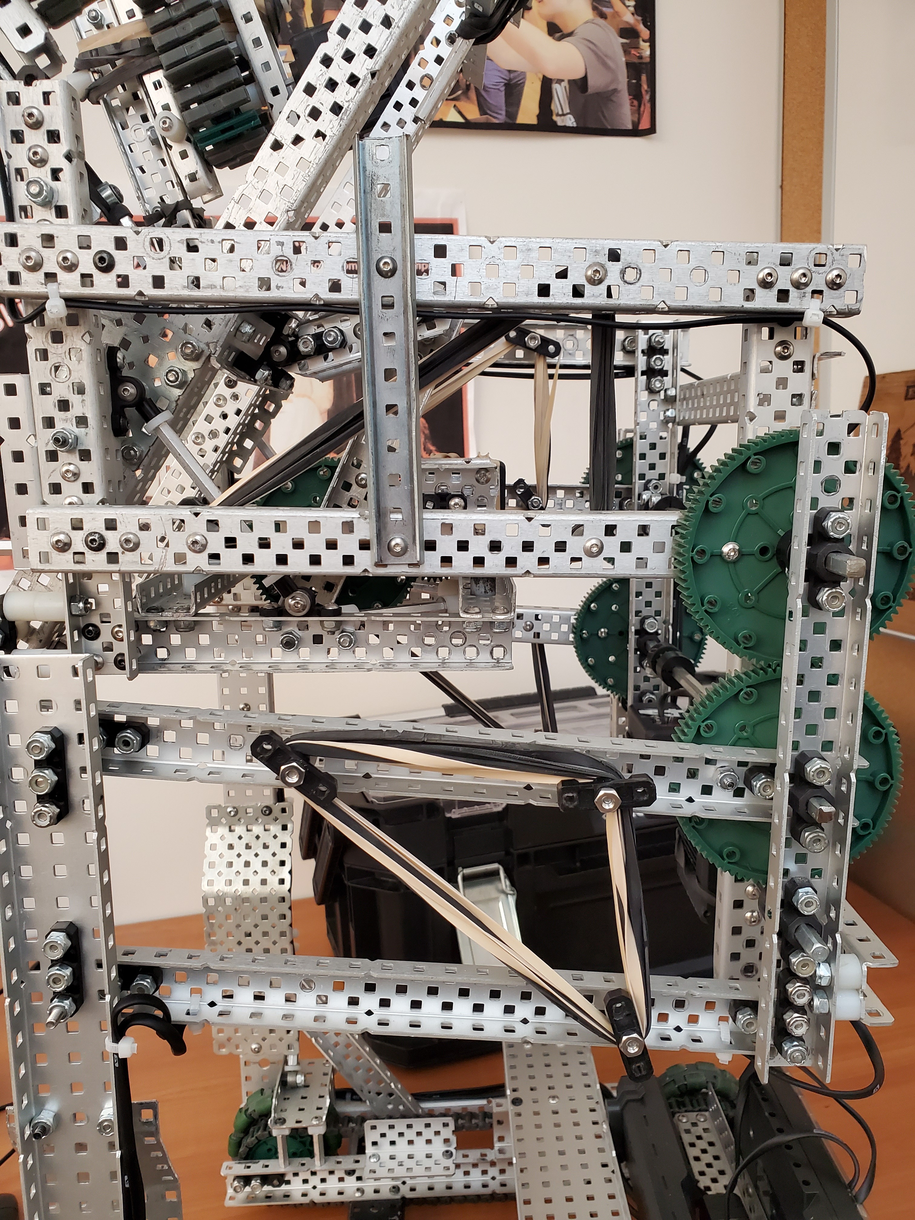

1571773989166433367788520526263
I counted the holes and they are mine tall and 23 long
Huh, maybe the difference between the diameter of a screw and the high strength shafts you’re using is enough to cause that (although I highly doubt the difference is significant). The only other idea I have is that your screws have shifted slightly in their holes due to the force of the lift on them. Hopefully it doesn’t affect your robots performance too much
Hasn’t been terrible. We don’t drive around with it up, just a little issue that’s be nice to address. Screws shifting would make sense.
