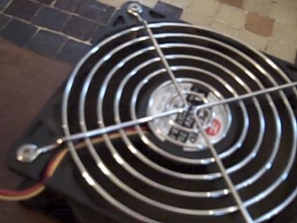

I recently found a big 12 volt PC fan in someone’s garbage (along with a fifteen-year-old mouse) that looks like it has a PWM cable. There’s a black wire, a red wire, and a yellow wire. I hooked up the black and red wire to a 9v
battery and it spun very quickly, but didn’t blow much. I’ll show a picture later. Do I need a relay? How do I wire it to a relay? What can I use the fan for?

You connected a standard 9-Volt Battery?? The amount of Current needed to run the fan at its full capacity was most likely not enough.
You would need a 12 Volt Source and either a Relay or a Combination of two of Quazar’s Circuits,
How to drive a small DC load via Digital Out and Secondary Motor Circuit.
What is the end result that you want to achieve with the 12 Volt PC fan??
Its not PWM, the third yellow cable just feeds speed information to the motherboard inside the computer.
Most of these fans barely pull 1 amp so the battery is not the problem, they don’t really push much air. They do require 12 volts to work well, but don’t use anymore they like releasing magic smoke.
Oh by the way you can pick these fans up for dirt cheap on www.newegg.com. There are new ones that are PWM controlled, they have 4 wires (one for PWM and other for speed).
Thanks! I’ll try Quazar’s circuit. I just used a 9v battery to test the fan. Here’s some pics. The fan makes a decent amount of air with a 9v.

I had a thread on this a while back. You could probably just hook it up to a motor controller if you want to be able to control the speed, but otherwise just give it power. Also, I happen to have that exact same fan sitting here next to me, it’s from a Win98 Gateway (teh suck!) You can run them directly through a motor port with out any major power loss.
You’re right, it doesn’t push much air, only around the edges.
The Fan’s requirements should be located in the center of the Blades. You might find the Current requirements here as well as the Voltage requirements.
I just mounted it to The Flexx to cool the battery.(possibly batteries because I want more battery life so the Flexx can go on long missions) I made it so you can manually turn it on and off. I’m just using a 9v battery. It works geat!:DYAY!!!
