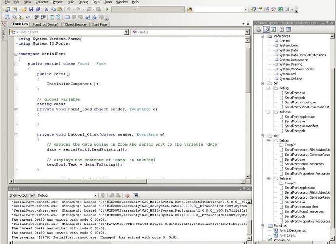

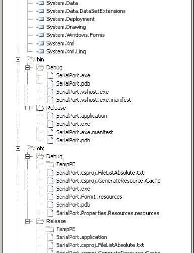

I can not locate your Source Code, just all of the system code.
Which Folder has your code:
https://vexforum.com/attachment.php?attachmentid=1806&stc=1&d=1245864959
Try double clicking the Form1.cs. Does it show you the form designer?
Yes:
https://vexforum.com/attachment.php?attachmentid=1811&stc=1&d=1245865961

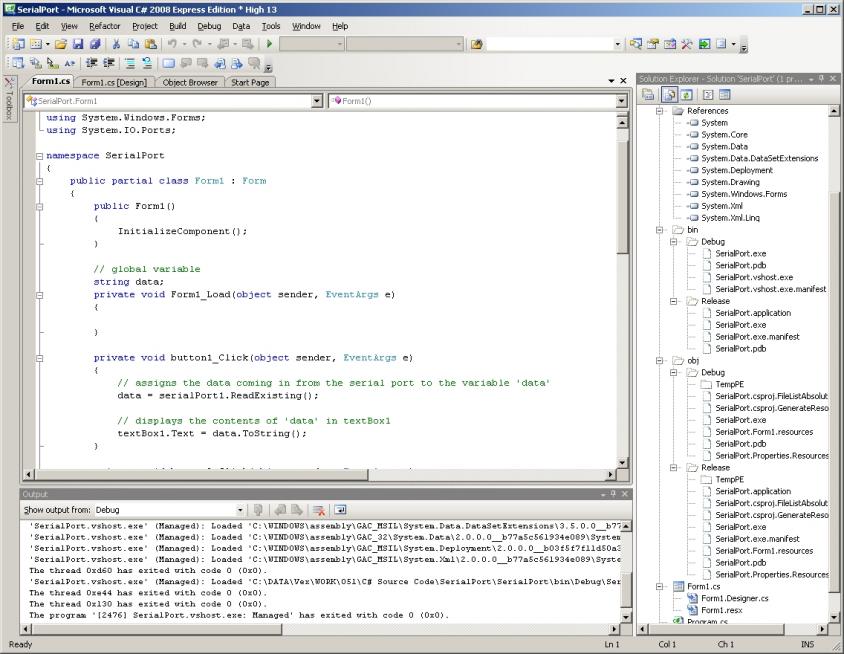

And you can’t view my code by double clicking on that form?
I can, also a Right Click on the Form and then Left Click on “View Code” works as well.
https://vexforum.com/attachment.php?attachmentid=1816&stc=1&d=1245866368
But, where is the Code for “serialPort1.Open()”, “serialPort1.Close()” and “serialPort1.ReadExisting()”??

It’s all right there. I have the program open the serial port when the user chooses what COM port they are using. Then I use the data variable to store the information coming from the serial port.
data = serialPort1.ReadExisting();
serialPort1.Open(), serialPort1.Close() and serialPort1.ReadExisting() are all part of the C# SerialPort class. I think that might be what you’re asking? I didn’t write the SerialPort class - I wish I could take credit for that though!

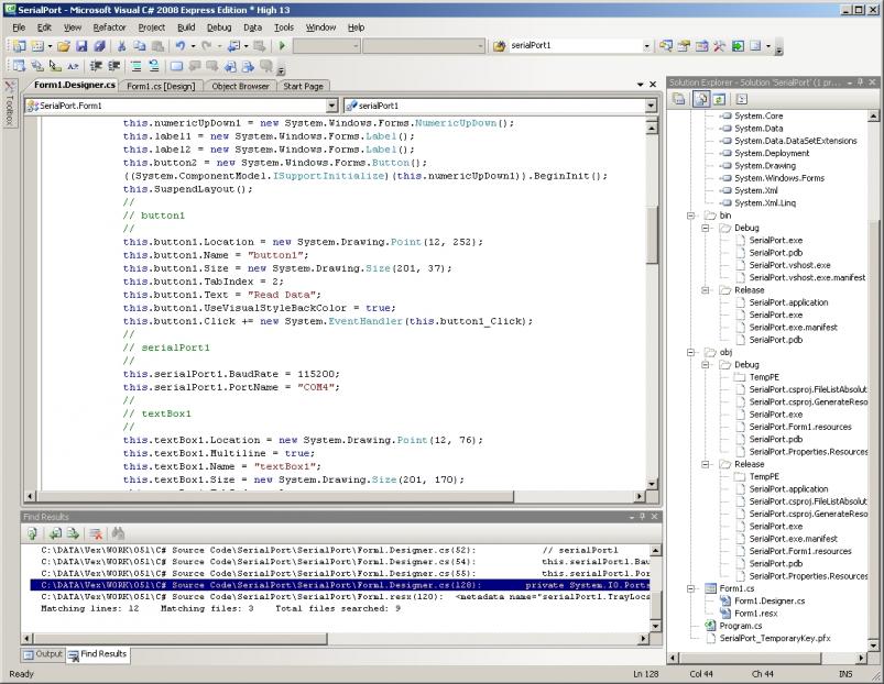

I found thisForm1.Designer.cs , where some Defaults are set for the Serial Port:
https://vexforum.com/attachment.php?attachmentid=1821&stc=1&d=1245867400
