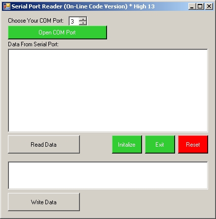

I am working on a Variation for the Vex On-Line Code…
https://vexforum.com/attachment.php?attachmentid=1836&stc=1&d=1245967292
I am having Issues with the Button States, since I can only manipulate the Button, after that Button has been pressed, and can not change the States of the Other Buttons.

Also, on your Code, I wrapped the above code with:
if (serialPort1.IsOpen)
So that a Exception would not be Thrown if you Press the “Read Data” Button, before Opening a COM Port.
The proper way to do that is to Grey Out the “Read Data” Button, if it not a Valid Action. I can set the “Read Data” Button to Greyed Out by Default, but as I stated above, I can currently change the State of a Button only, after it has been Pressed, and if it is Greyed Out, You can not Press It.
I need to discover how to Manipulate the State of a Button(s), based on other Criteria.
